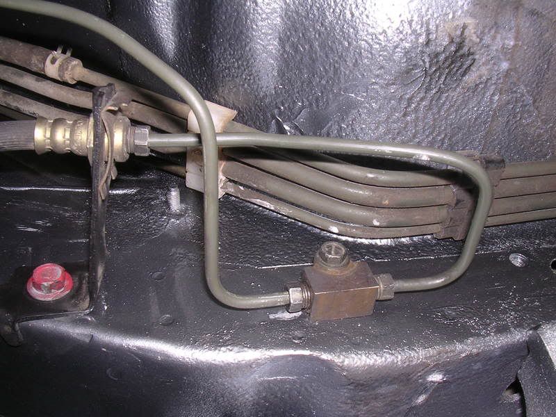

Today I tackled the assembly and bleeding of the clutch line and slave cylinder. This is part of my on-going attempt to turn my 1992 240sx into a 180sx. The entire build thread can be found here:
http://www.zilvia.net/f/showthread.php?t=182565
I'm not sure what the two foot loop of hardline connected to my clutch line is for, but this is how I corrected it.
I took a spare section of line from the front clip, and measured out how much I would need.
What it looked like when I started.
A new end was needed after cutting the line.
And the end result.

You could have just removed the whole dampener and just ran the hardline straight into the slave cylinder.

Ya, but I like the idea of retaining the flexible line between the body and the transmission to absorb vibration/movement.

i think he meant you could get rid of that copper block. its completely useless

i just bent the hardline around straight into the soft line leading to the clutch slave. , no real need for that 4 inch section of line with the union bolted to the frame rail, its just another place where fluid can leak from. but that does look really clean. alot cleaner than most any ive seen for sure.

removing the damper ftw. it's entirely useless, and the clutch pedal feels way more direct without it.

Oh whoops, I mean the hardline off the master straight into the rubber line.

or just get a ss line from clutch mastet straight to slave

The only problem with that is that if it's not teflon coated, you'll have this nice long stainless line that's prone to vibrations. And vibrations with stainless lines = a saw in your engine bay.

you did too much work IMO... also should have replaced that hard line with a SS line

Um, what? You did a writeup on something that we've been doing for over 15 years, but managed to add a step and make it harder to do? Now that's a new one.
You can bend the line 90 degrees around and screw it right into the rubber hose, eliminating the block completely. Just like the other 30 or so writeups found online.
As for this comment: you did too much work IMO... also should have replaced that hard line with a SS line.
The hardline is already steel. I think you meant the rubber hose.
mine does have it, i didnt buy it till it was corrected
