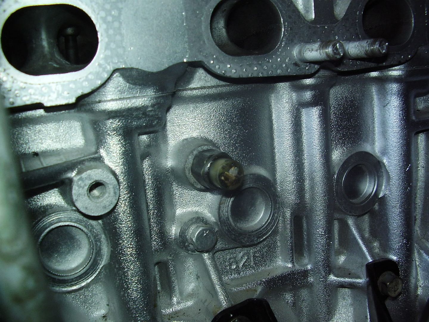

I've tried searching all over the place, I just got this SR20det from a friend of mine freshly rebuilt. I installed it and went to replace the turbo and manifold and found this sensor underneath the manifold was busted
Here are some pictures.
I can't figure out witch sensor it is and my buddy doesn't know either. Any help would be awesome!

Knock Sensor.

Theres nothing special here just seems that someone placed a tranny sensor or some other type sensor to plug a water line port for whatever reason.

The weird thing is why is it their, usually Nissan puts it on the intake side.

I know the s13 sr knock sensor is on the intake side Is it an s14 sr? plus it doesnt look like a knock sensor. there is a similar sensor like that on the tranny. very different???
BINGO!!!

No, this is an S13 red top.
That's why this was so confusing because I couldn't figure out what type of sensor is plugged in there with the clip busted off.
So what..? Is this the port for the banjo bolt for the coolant line for the turbo?

definitely not a knock sensor

no its just a port to drain coolant from the block, its ok dude dont worry about it.
I thought it was a knock sensor because the CA has a knock sensor similar to that, only difference is the top portion is a see through green.

So they just plugged a drain hole?

yeah. probly lost the original plug. if you want the KA plug might fit, its in almost the exact location.

No, I answered the question in my first reply. Let me be a little more clear, its the water port on the block that feeds the turbo which is blocked.

Ok that's what I thought it was in the first place.

fuck! your right. i wasnt paying attention to the picture. my bad guys. you can leave it plugged though. there are alot of people that dont run the water lines.

But dont do what most people do, run your water lines.

very true. I run the water lines on my sr, im pretty sure there there for a reason. god, now that i look at this whole thread its actually pretty funny.

Save yourself a headache an get braided lines. I still have a banjo for oil in, but it disconnects leaving the banjo fitting and bolt attached to the block
This is correct. Observe the picture below.
The blue fitting is an -6 AN cap on top of a threaded fitting. This is the proper way to plug up the coolant outlet for the turbo.
This is the part number for the cap:
I don't remember the size on the threaded fitting, but it's in one of my previous posts as well as others'.

I was not running water lines on my T25 because I was removing the turbo a lot to do maintenance and test fittings. So I didn't want to slow myself down with water lines.
But others may choose not to run water lines, you should run water lines if the turbo has provisions for them. It helps longevity.
