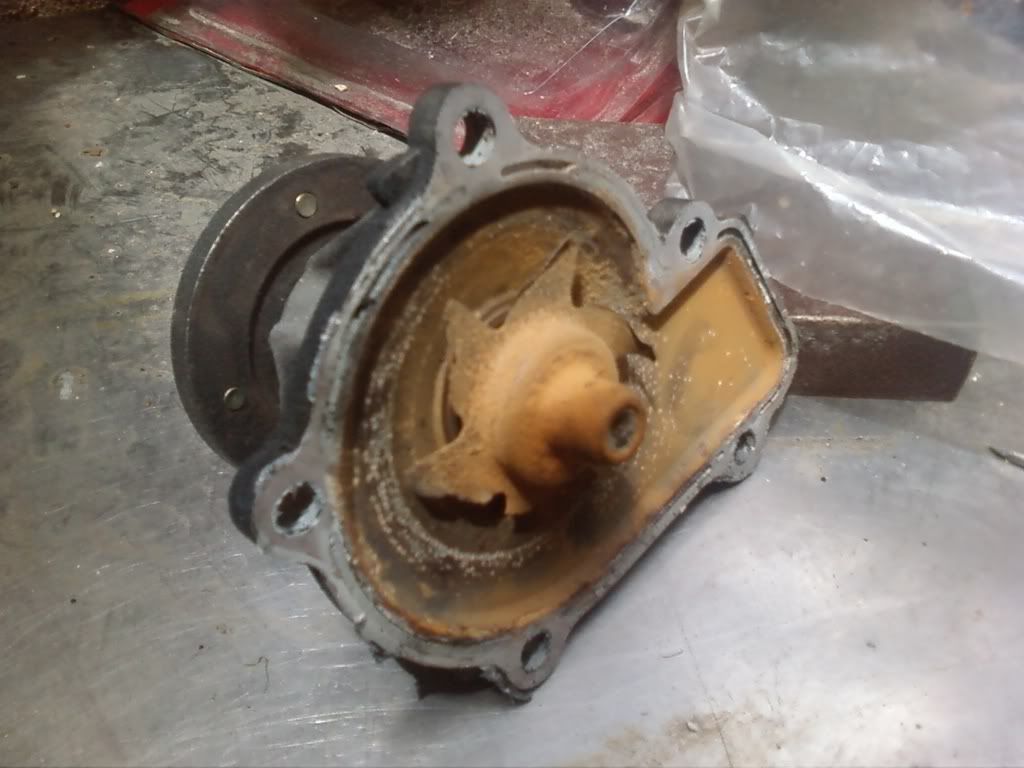

if your coolant or water looks like theres rust could be your waterpump
heres what mines looked like after my overheating problems
ultimate FAIL

If it stays cool when drivinbg then its probably your fans. if it over heats right off the bat when you start it up in the morning and barley get down the road, then either therm stat not opening water pump not pumping or your using water by burning it up from bad head gasket or leak of some sort. check all and when in doubt use manual switch for fans
