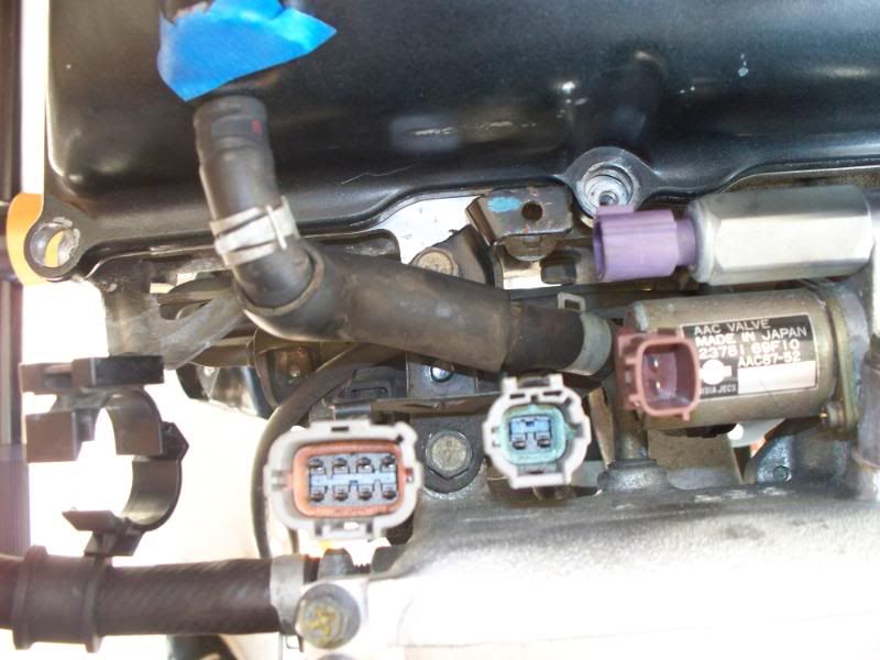

heres the random plug that goes under the manifold, whats its for?
Also theres is this plug out front, is this to be unused...

first pic is the knock sensor harness, so even if you get it to crank ur gonna have problems, your harness is fucked up, second pic looks like the plug that goes to your crank sensor. there should not be any unsed plugs there? get it redun befor you go any further, hope this helps bud.

first plug in pic is the injector harness and the second one is the knock sensor harness.

i'm confused on that last brownish plug by the tps though. it's bugging me lol, you have the tps plugged in which is good, and you have the vvt plugged in, and you have the cas plugged in cause i can see it reaching around. the only thing i can think of is it goes to the coolant temp sending unit and the coolant temp sensor, that'd be about the only other thing around that vacinity *shrug. i'll take a look at an s14 sr when i get to the shop tomorrow and see. anywho, glad it works :P i think whoever converted your s14 sr20 harness is an idiot and should be shot. i bet he drives a gay ass datsun of some kind. he shouldn't be allowed to work on cars rofl.

As for the other plug everything around it is plugged in, throttle senor, cas so I'm still confused..any one help me out on that one??

i looked at another s14 sr20 here at the shop and that left over plug by the tps doesn't go to anything. perhaps it was an automatic s14 sr harness and that is the kickdown plug for the tps, but since you have a 5 speed tps/motorset it's not needed. tuck it away, cut it off, light it on fire lol. other than that the coolant temp sensor and sender plugs just come out of there and go straight to the sensor, there's no sub harness for them. you need to find your knock sensor or a knock sensor but ultimately i can't see the car not being driveable without one. i'm glad the guy who wired up your s14 sr into an s13 chassis didn't mess up your harness after all...... ^_^
