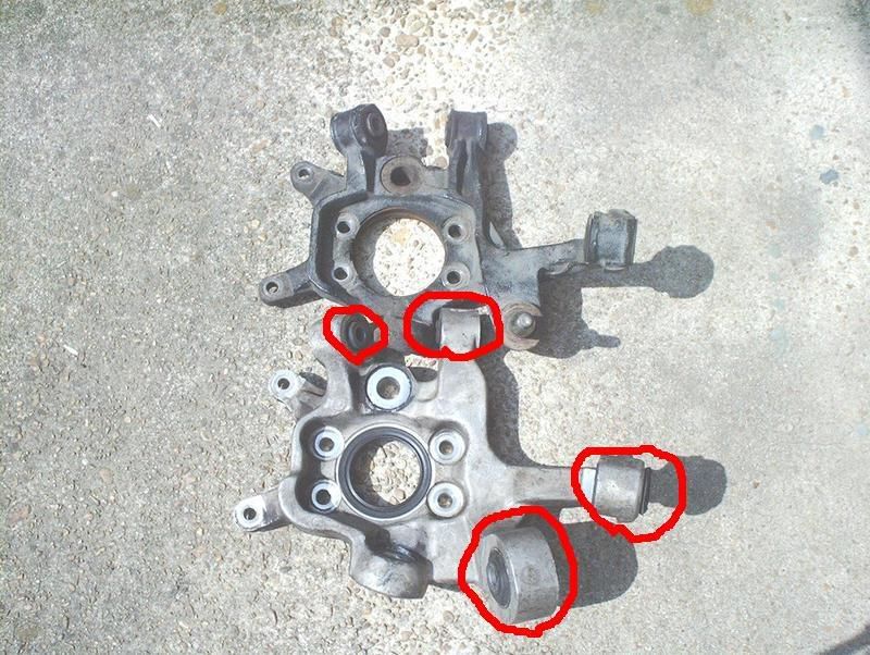

So I'm in the process of removing my aluminum Z32 upright bushings in order to put in new ones. I know their pressed in and so I tried the bolt and socket trick but some won't put out with that method. Does anyone have any other ideas?
I circled them in red to show which ones I'm taking about.

drill thru the rubber with a tiny drill bit.
then push / press out the inner sleeve.
cut thru the remaining outer sleeve with a hacksaw, being careful to avoid cutting the aluminum, if you do (and you will) just sand the area smooth.
easy peasy.

18MM and 32MM sockets on either end, in a vice. Three seconds.

I tried putting in a socket like that and those stupid bushings are JAMMED in there. I ended up using a breaking bar on my vice to turn it and it bent the handle on the vice. And I still didn't get it out.

naw you cant just press them, some of them you can but these rubber stupid ones you gotta hole saw the rubber out of it, cut the metal sleeve with a saw(this takes the pressure off the metal sleeve) then you can hit it out with a hammer and a socket. I had to do this when i put in the energy bushings in my car.

You're crazy too, I've pressed out over a dozen sets of bushings from Z32 uprights. They're easier since the steel outer shell doesn't seize to the aluminum. The S13/S14 uprights being steel are more work since the steel will corrode and seize, but these are simple. I've never had to use anything but sockets.

I pressed mine out no problems. You can even do it with a 6" Harbor Freight c-clamp until the thing splits in two pieces(with only my hand on the 4" bar.. haha)
There is no clip on them.

Some of them have a clip that goes around the back - if you take that out, you can just press em (in my experience). I'd have to see 'em to be sure, but I had J30 RLCA's on my S14 when I picked it up, and dealt with all that shit.

I did all the bushings on those z32 uprights... I burned the rubber out with a propane torch and used a sawzall to get the sleeve out.
Lubed em up and they slid right in with a press
