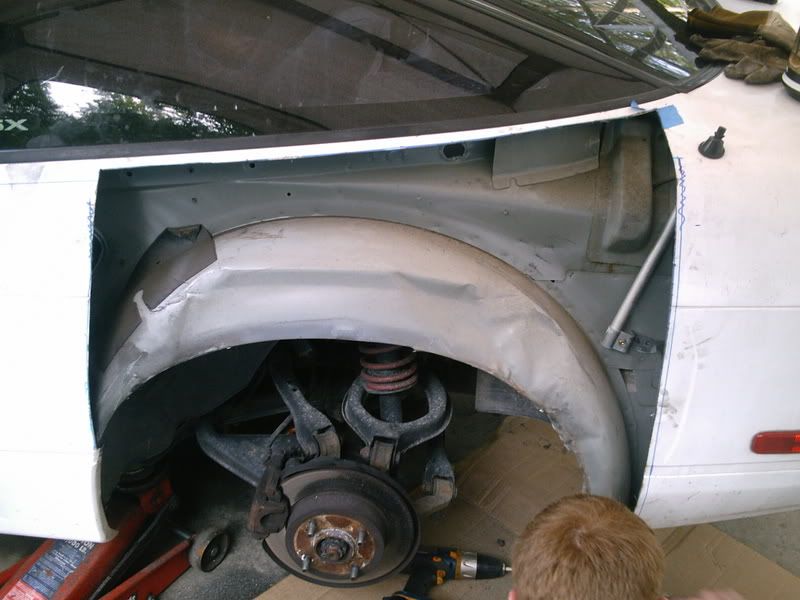

what about drilling out the spot welds? it will have to be done anyways. To get my QP I drilled out the spot welds, cut the metal off at the middle of the rear window, side window, and wheel well.
