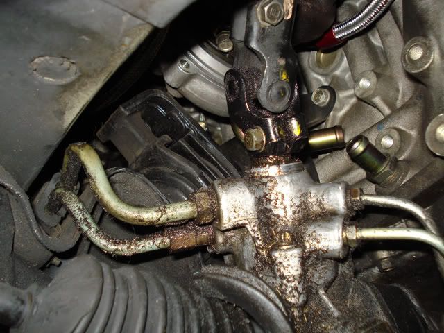

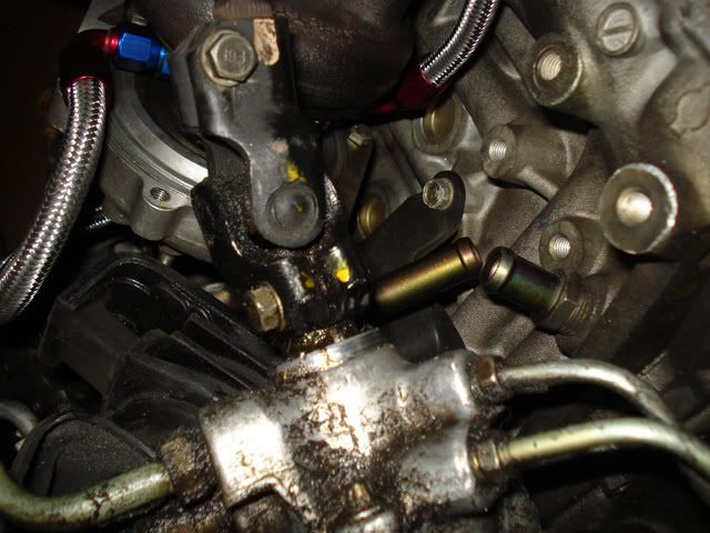

I got a couple of pics of the oil return tube from underneath the car.
Ignore the nasty grime on everything. The steering rack boots are torn and the rack itself is spitting fluid out everywhere. I am just waiting for money to get some Tein tie rods and ends so I can put my HICAS rack on.
Anyway, here are the pics:
As you can see, the tube is pretty much right up on the fitting on the block. I'm pretty sure that there is supposed to be a little more space in between those 2.

So... what exactly is so different between the S14/S15 motor than the S13 motor to make it so that when you're using all OEM parts, your shit still don't fit on the S13 motor?

I've seen a few people say "cut at the bend and weld it on a different angle" for the S15 oil return tube.
What exactly do you mean?
Do you cut right where it goes from straight and into that turn? Or do you cut mid turn?
Basically, does anyone have pics of what they're talking about? Because it is now 2008, and all the threads that covered this in like 2002/2003 are all pictureless now.
