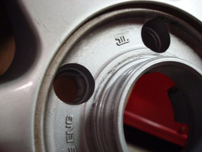

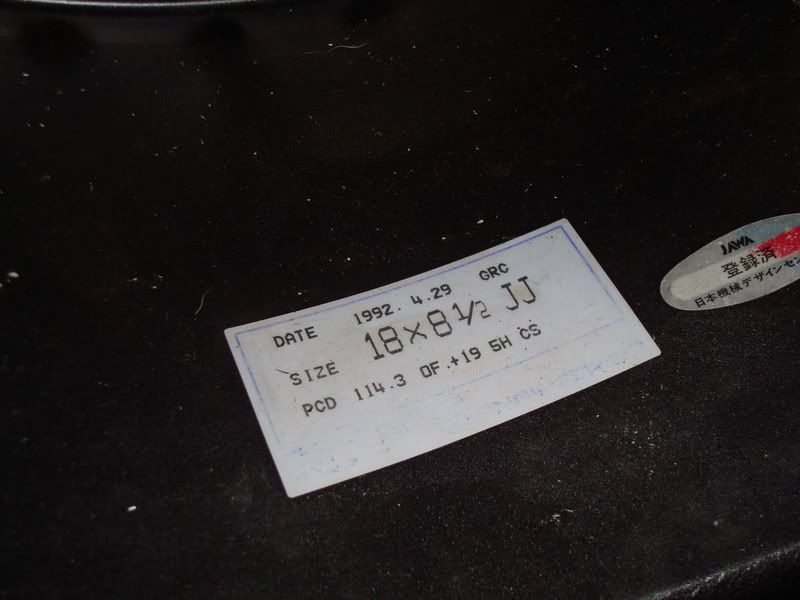

So I picked up a set of old school Volk GR-C's yesterday, and now I'm abit confused as to how these wheels work. Their two piece wheels produced in 1992, the sticker on the inside lip says the wheels are 5x114.3, BUT when I bought the wheels the seller gave me spacers with them saying he needed these to make them fit on his skyline. I assumed he just meant for clearance issues, then when i got them home I realized the bolt patten on the actual wheel is 5x100 and the spacers adapt the patten from 114.3 to 100. So i did some reseach and came to the conclusion that volk only made these wheels in 5x100, but sold the needed adapters with the wheels for other 5 lug applications. I am Right here?

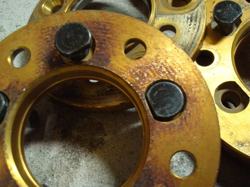

Second the spacers only came with just ovber 1/2 of the studs. does anyone know where i can get replacement studs like theses?
Third, the lug holes in the wheels are EXTREMELY Shallow and narrow, tuner lugs could fit width wise, but the holes are less then an inch deep and the ring for the center caps sits basically flush with the top of the lug holes, so if their any longer then the hole size the center caps wont be able to go on. Did Volk make special lug nuts for these? or can I get open end tuner lugs or something?

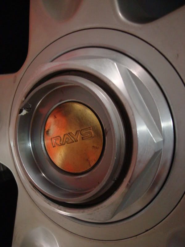

Lastly, I'm missing one of the center caps, so if anyone knows where I can get one or two I will love you forever.

I'll take a pic of my center cap for you, All the GR-C's I've seen have had your cap, never seen one like mine before... I know a few different Volk wheels use the same center cap, but different outside rings, so you might be able to source a cap but just get a ring made.
Jspec, I'm thinking old volk wheels since they used the same center caps only came in a 100mm bolt pattern (5x100 or 4x100) or else they would have the make a bigger center cap? So when a 114.3 pattern was ordered they sold spacers with them?? thats my theory anyways.

im not sure where you can get replacement studs. but you can get 5x100 ---> 5x114.3 adapters/spacers on ebay or get them custom made. it might be better to just get new ones instead of re using those.

I think I have a solution for the spacers. If i drill out the stud holes to 1/2" That will allow me to press stock studs into them, I'd just need to grind acouple mm off the side of the stock studs as they JUST hit the flat spot made for the other studs.
Edit: Heres the pic of the center cap for "-m-". I'm not sure if you can see from the pic but there is threads in the gap between the "rays" center and the outter aluminum, maybe the "Rays VR" cap screws into there and is removable?

You can get different spacer/adapter sizes if you're not happy with those. As for the studs, you're better off buying a new set cause you'll have a hard time finding replacements.
