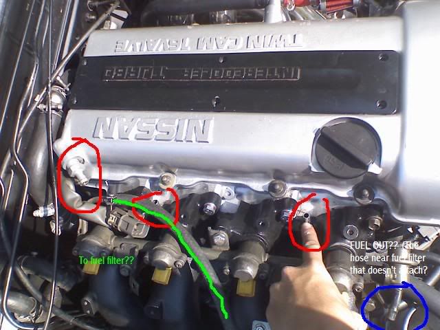

So, I've searched for about 30 -45 minutes now, looked at my shit over and over again, pictures on here.. Whatever I can't find anything that I can relate to.
Ok, circled in red I have 3 nipples (two from intake manifold, one from valve cover) that I have no idea where they go.
Green, I have the hose that I assume attaches to the top of the fuel filter if I'm correct?
Blue/white. FPR, I attach the hose from here that goes back to the tank or whatever? (Near the fuel IN hose??)
Thanks for the help.

Hope this helps looks as if the 2 smaller nipples on the manifold connect to each other and the larger red one on the valve cover attaches to those...
green i beleve is to the fuel filter, and the blue is back to the tank...
