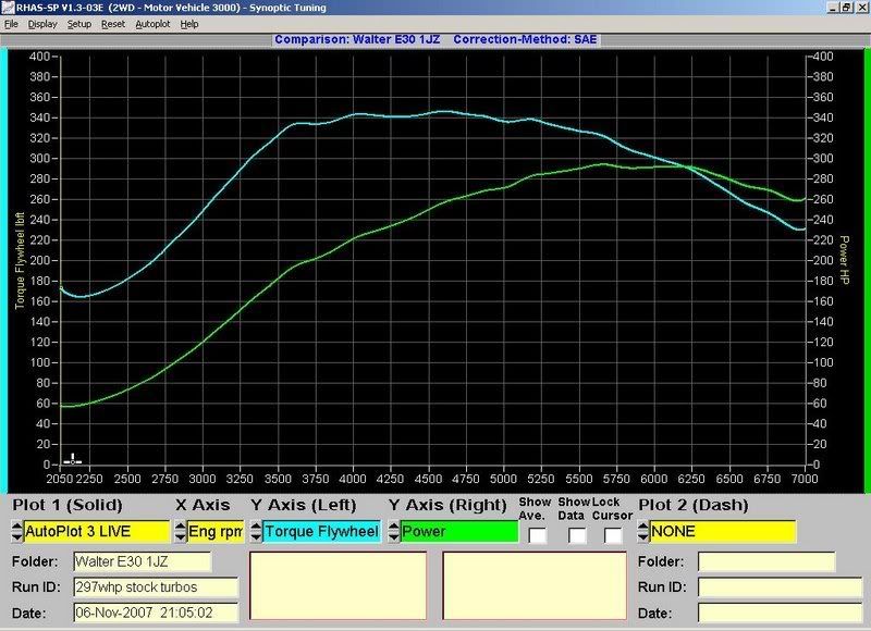

Here Is The Dyno Graph For a Stock 1jzgte at 13 psi
R154 Gears Ratio
  • First Gear: 3.250:1
  • Second Gear: 1.955:1
  • Third Gear: 1.310:1
  • Fourth Gear: 1.00:1
  • Fifth Gear: 0.753:1
My Car Weight Is About 1300 Lbs
My rear End Ratio 4.083
Rear Tires 205/60r15 (255/45zr17 Next Summer )
280 Hp @ 6200 rpm
268 Lb/ft @ 4800 Rpm
It's not a Track Race car , It's My Summer Daily Drive , Just want To make The Car more Fun To Drive ... With This Ratio And Shitty 15 Inch Tires , I'm Running Out Of Gears Very Fast ...

Those gears don't look that different from stock SR gears. I think a 3.1x final drive would make the car a complete dog.

Gear selection is dependent on torque also. He has a lot more bottom end torque than a typical SR.

I understand how it influences it, and I could see wanting a bit longer gears for a street car, but a 3.13 will still make that thing a dog. It's only a 2.5L engine off boost.
Didn't Q45's have a 3.6x? I think that'd be a lot more reasonable with how much power you're making.

Alright, you've done everything I asked so I'll do my best to help you out. Keep in mind though that I am severely limited. The best way to select gear ratio is with onboard telemetry. Everything I'm doing now is just approximating and using my experience to help guide you. It's not 100% perfect but I think it's the best anyone can do for you online.
Let's start with my car as an example. I don't care about the power curve. I'm interested in the torque curve. It only revs to 5100RPM but I'm set up for low speed autocross and short roadcourse so it's perfect.
We're interested in the net torque at the driving wheels. This is on the stock 4.0833 diff. World Class T5 5-speed ratio: 2.95,1.94, 1.34, 1, .63. The wheels rotate 841 revolutions per mile.
I know this chart is strange for a lot of people. This is rear wheel torque in each gear for different wheel speeds. The horizontal axis is MPH, and the vertical axis is ft-lbs of torque. Blue = 1st gear, pink = 2nd, yellow = 3rd, baby blue = 4th, and purple = 5th.
You'll notice that the curves look a lot like the engine's torque curve. The only difference is that the curve at the rear wheels are stretched horizontally and vertically.
With this gearset, the engine revs up way too quickly. Top speeds in each gear:
1 - 29mph
2 - 44mph
3 - 64mph
4 - 85mph
5 - 135mph
The car runs out of steam too much. I'm in 1st and 2nd for less than 1 second each before the engine bumps up against the rev limiter.

The only change is from the stock 4.083 r&p to a Pathfinder 3.133 r&p.
If you pulled up the two charts side by side, you'll start noticing some interesing things.
Top speeds in each gear are now dramatically increased:
1 - 38mph
2 - 57mph
3 - 83mph
4 - 111mph
5 - 176mph
The more important thing is look at the speeds that you want to maximize torque to the rear wheels.
For the type of driving I do, I run max 80-85mph at most, and typically I stay in the 30-50mph range. On the old diff, I constantly have to shift between 2nd and 4th. The torque to the wheel is good but I'm wasting too much time shifting because the engine is revving up against the limter too quickly.
On the new diff, I can pretty much leave it 3rd all the time and not waste time shifting. I'm not putting down as much torque but I'm saving time shifting once or even twice.
You have to find that balance between putting down enough torque to the wheels with mechanical advantage through gearing, and wasting time shifting.

This is your torque curve based on the numbers you gave me:
