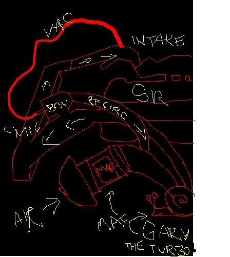

there isnt no point to this thread.. this is all you will ever need.
