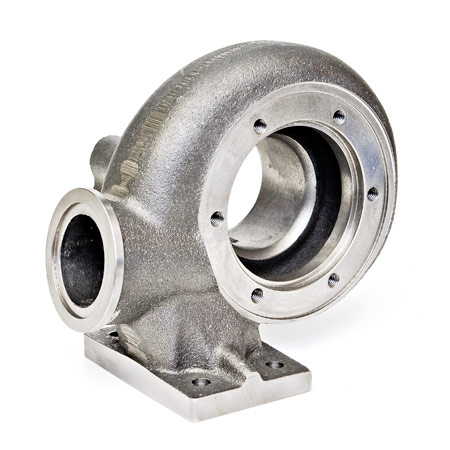

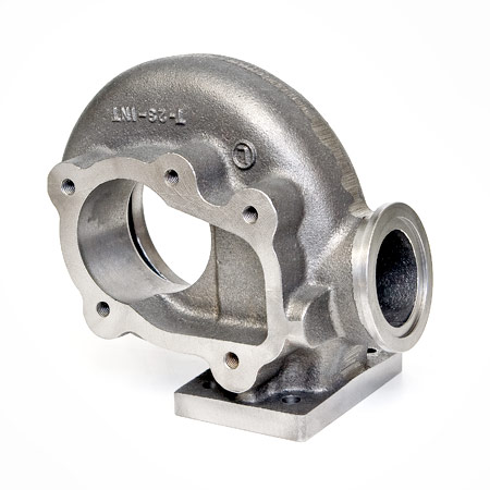

Special Turbine Housing T25-EWG-44, 44mm WG on T2x
Now you can run a 44mm external gate without having to get a special manifold on the T2x frame turbo's.
Special Turbine Housing T25-EWG-44: atpturbo.com
My question is would this hit the strut tower / wheel tub?

from the pics wouldnt it hit the block instead?

It faces out the other way...down and away from the block when you put it on.... Bottom mount of course...

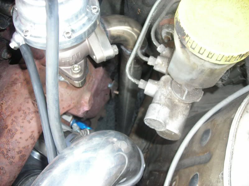

its tough to visualize but i think it would actually be closer to the strut tower side, and there's definitely some room to play with over that side
EDIT: My setup...
I ran out and did a quick measurement in the freezing cold just for the hell of it and the tial would be VERY close to the strut tower unless I'm visualizing it all wrong

So it looks like 5" tall with the added flange.... So see if we have 5 1/4" inches from the turbo turbine side...

my 2871r is external and i <3 it. I think the turbine housing is SICK if theres enough room

i think this might solve the clearance problem. The one on the right is a new wastegate from tial. Its alot shorter. The only thing I'm not sure of is if it uses the same size v-band flange as the v44.
Description from Tial:
TiAL will be replacing the F38 wastegate with the new MV-S wastegate. Small was on our mind when we developed this new ultra compact wastegate. It stands only 3.7" in height vs the current F38 which is 4.85" Other features include 3 bottom pressure ports for easy install and a top mount pressure port that can be rotated 6 different ways. No more bolts or gaskets and all configurations are leaded fuel safe. we also altered the way the diaphragm sits so it is virtually impossible to pinch. A late fall release date is scheduled.
