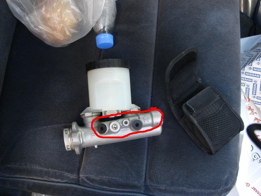

Proportioning valve is likely bad, I've had a few do that.
FORMERLY R240NA
Old 02-15-2009, 03:01 PM   #3
Ali 556
Location: Far Far Away......
Posts: 359
Ali 556 is a well-known jackass
where is that...BMC?
'95 S14 Se With HKS's - BREMBO's - ES/SPL.
Ali 556 is offline   Reply With Quote
Old 02-15-2009, 05:27 PM   #4
projectRDM
projectRDM's Avatar
Join Date: Dec 2002
Location: Atlanta
Age: 51
Posts: 13,812
The piece threaded into the BMC that the rear line runs out of.
FORMERLY R240NA
Old 02-16-2009, 01:57 AM   #5
Ali 556
Posts: 359
you mean this :
http://i198.photobucket.com/albums/a...g?t=1234774461
and do you know how to fix it...it's brand new with less then 1k miles on it...bought it 3 months ago...damn
