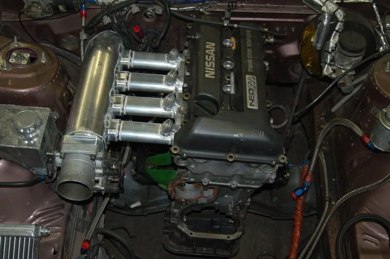

A friend decided to donate his car for a build we've been trying to work on. This will be a SR20VE head (VVL) to a SR20DET block. For those that dont know much about the VVL head, its pretty much a Honda VTEC setup, so VVL head + boost ='s much power and less head breakage of parts. The VVL head flows much better and has stronger components than of the regular SR20DET head. This is the same head we run on our drag Silvia S15 better known as "The Green Machine"
Here are pics of it starting to pull the motor apart.

Just wondering, are you goin to keep the VVl setup? Or are you going to get cams to keep all the lobes the same.
Becuase i know companys make cams that "kill" VTEC.
Boost +short runner and your good.
Also, does this raise your compression?

Here is the dyno sheet before the VVL Head:
Stock Block SR20DET
Apexi Head Gasket
HKS Valve Springs
New OEM Valve Seals
Hybridynamics Turbo Kit - Exhaust Manifold, Tial 44mm Wastegate, Lines, Downpipe
SARD 850cc Injectors
Garrett GT30R .63
Hybridynamics tuned using NisTune
The car is primarily used as a street car with occasional drag and road racing days. Last year the car went 11.794@115 with this setup.
