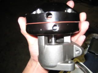

Hey guys finally got my car running great . Took it for a drive and it was hella quick. then I looked at the guage and its boosting 30psi for stock internals!! omg. and the external wasgate is set up for a 8psi spring.. wtf right? well there is no way I am going to drive lke this lol. Could I possibly connect a manual boost controller to lower the boost? i might of mixed the vacuum line bu i dought it since i got boost. but here is what she looks like

Thanks. At the end of my exchaust manifold where I hooke up the wastegate. I put
1. gasket
2. The metal round ring
3.wasgate then tighten it in
4. then the dump pipe.

Ive tested the waste gate on my compresser.connect to turbo housing. as for vacuum source, its connected to the bent nosel below the throdddle body. there also a T fitting on it that goes to the Boost pressure silinoid.
Ill drive around 3g to 4g and let the gass off. i can hear the quiet waste gate cha cha cha. not the bov.

All the vacumm was correct in the first set up. but still boosted high so i took it off.It was all black and the dumptipe too. Test the compression to my guage and to the wastgate. theres a 30psi spring in it.. so now im searching around for a 7psi spring

How did you test the "compression to the gauge and wastegate"? The way I've tested them is with a bicycle pump and just see when it starts to open, but there aren't many pumps I've seen that'll do 30psi... did you use an air compressor or what?

yah i used an air compressor. small one with an adapter , that can ease the air so its like a bike pump. took alot more effort to oopen it up. as for the guage. it was flying to 30 with the same pressure, not sure where i can get a spring tho
