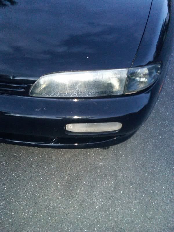

i guess laquer thinner eats plastic? was using it to clean lense...

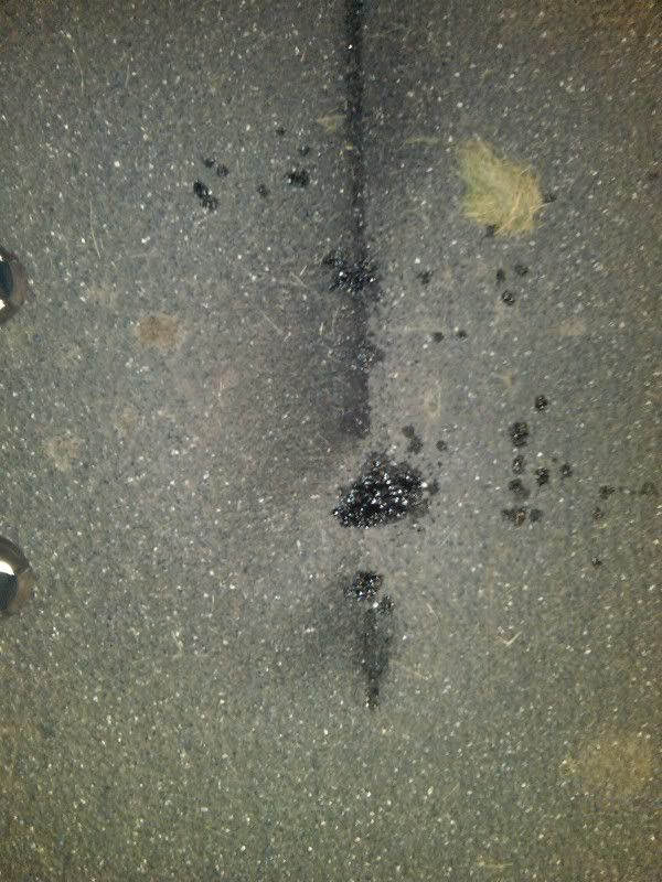

what would you expect if you saw this under your car one morning?

so i took off the oil pan. cleaned it all up put on rtv silicone high temp (black) on the pan then I laid down the felpro cork gasket on the oil pan.
bolted the pan back on. put some rtv around the edges just in case. let it sit without oil or anything for 18 hours.
added oil in the morning. drove it for 15 minutes. came back home looked under the car and it's dripping just as bad if not worse..
not 100% sure if it's leaking from just the pan, or the front main seal as well as the pan... this is being a pain.

Probably front seal.
easily doable, just real time consuming.
make sure you dont have any metal in your oil.

leak was most definately the crank seal (front main) looks like the pulley was scored had a circular cut in it maybe a rock got stuck on it and spun around with it for a long time. put some rtv on it for a quick fix. doesnt leak anymore.

got new headlight lenses and put them on. was a pain but I heated up the oven to about 200 degrees F and put them in for about 5 minutes took them out and pried them off. tar gets really gooey. becareful not to melt any of your housing.
