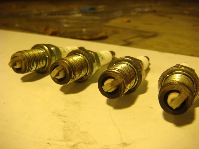

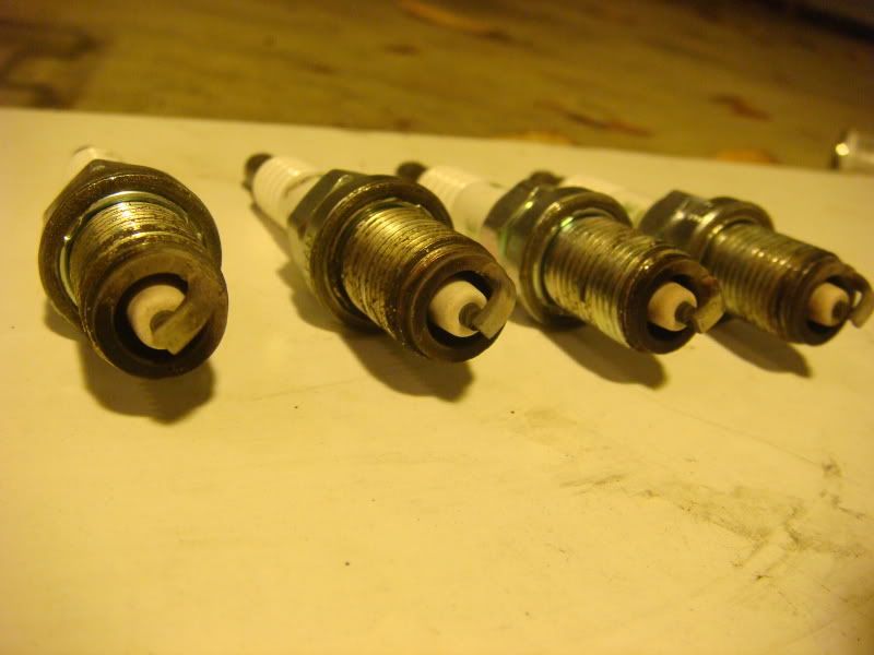

So at the very same time I fixed my clutch problem,another problem came up, WHITE SMOKE!!
This morning I fired up the engine as usual. I stood outside and watched the normal cold engine white smoke to clear. All of a sudden, the exhaust threw a thick heavy dense white smoke, I know instantly it's coolant judging by the amount of smoke. For another 2~3 minutes, the smoke becomes thinner but remained in a large amount. It didn't stop until I turn off the enginer after another 5 mins. I found the coolant resevior had a 1/6 tank (about 1/4 from max line to bottom) sucked out.
So later afternoon, after some research, I went back to the car thinking to perform a compression test. funny thing, the white smoke is GONE!! There was still the white smoke you get from a cold engine, but as soon as the engine warms up, they just disappeared! I went for a 10 mins drive and everything seems normal, etg, boost and oil pressure gauges. The coolant resevior level didn't change and everything seems normal.
Is that a sign telling me that the headgasket, valve stem, piston rings, turbo, etc are about to give out?
anyways, here is the compression test w/ warm engine.
143-142-142-145
Stokish s14 sr20 (have new injector rings, so it is not injector)
