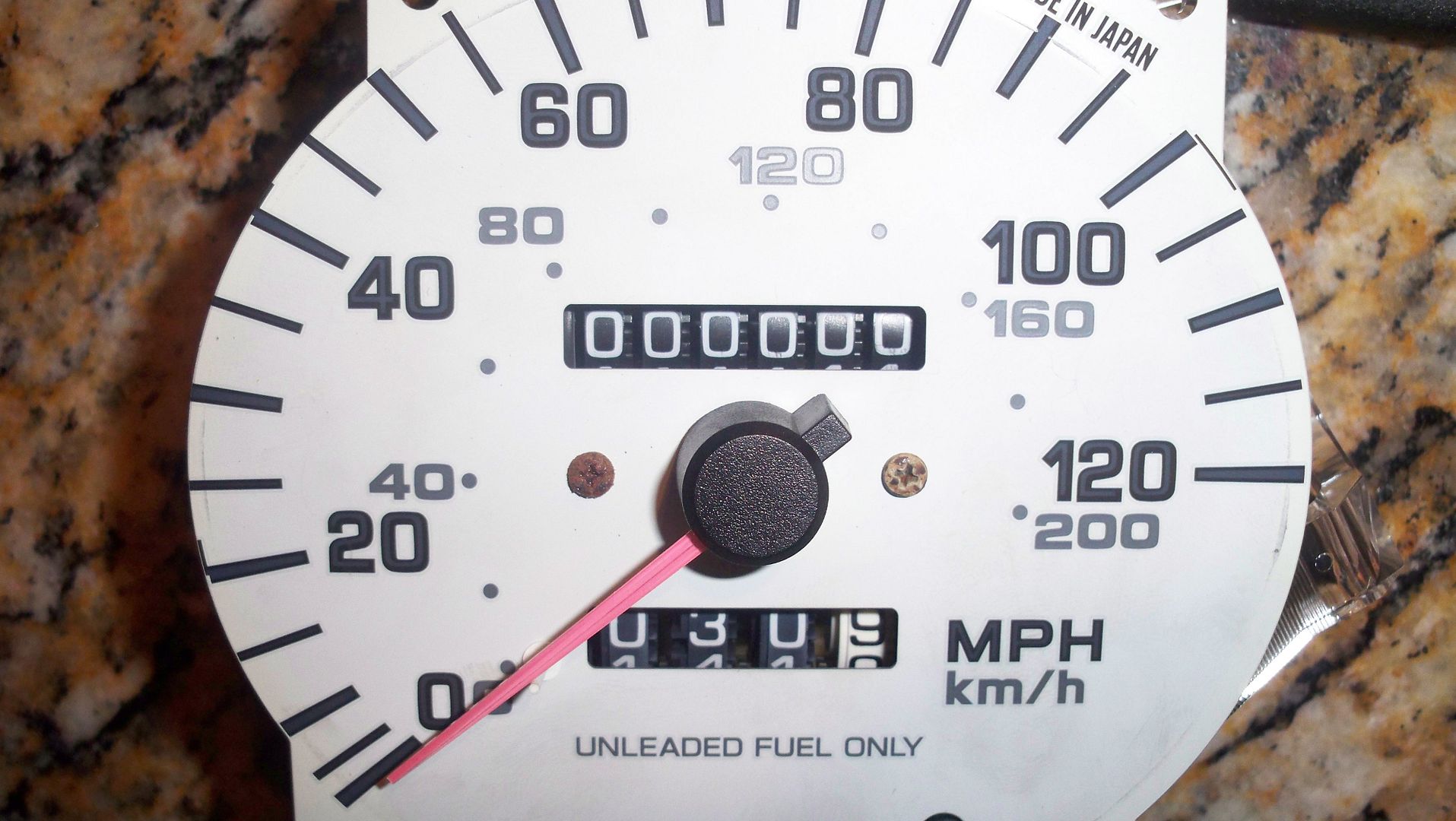

First step is to take the speedometer out of the cluster.

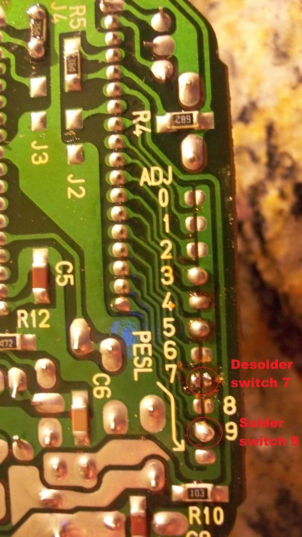

now you turn it around and look at the circuit board on the top you will see the letters ADJ with numbers, these are the adjustments.
Now unfortunatly i did not take pictures before i started, but the circled portions are what is soldered from the factory.
This is the tricky part, given what diff you are running and your tire size it can change the percentages of where it needs to be.
My setup is j30 (3.90) rear with 18s out back, most 18 tires are 25.2-25.6 inch diameter so this should cover all popular non stretch sizes
what you need to do is solder pin 9 together, bridge the gap so to say and desolder pin 7, open the gap. As shown in the rear picture.
This got me exact on my car tested up to 100mph.
Now thru the miracle of mathmagic, i was able to come with a combo that should get you close for a stock application 205/55/16 with a 4.08 rear diff, it should be plus or minus 2 % ( ie at 100mph you could either really be going 98 or 102)
You still need to solder switch 9 and 6 and still desolder switch 7

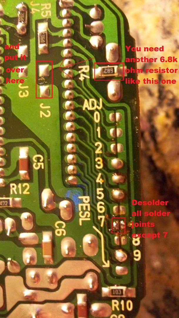

NEW AND IMPROVED METHOD
SUCCESS!!!!!!
In my trial and error aproach, i found the right circuit to put a resistor to fix the odometer. The only problem was apparently it reduces the signal BEFORE it goes to the speedometer so after that odometer would read right less than 4 percent off ie (travel 100 miles and odometer will show 103.6 miles) , and the speedometer was decreased by half. So all the adjustment i did up in the first post was cancelled out.
Here is the new and improved method.
Assuming of course you are starting off with a usdm speedometer that reads in mph. Desolder all switch joints EXCEPT number 7. This will take care of the speedometer.
Now here is the tricky part, you need to aquire either a resistor from another cluster ( the circled one in the picture) or aquire a new 6.8k ohm surface mount resistor ( should cost no more than .50 cents). And solder it where i show in the picture the j2 solder.
This will fix both speedometer and odometer. If you have another spare speedometer or circuit you can just swap it over, thats what i did.. best part it was free.
Heres the pic
also from knates thread on freshalloy the adjustment ranges
ADJ 9: -49.4%
ADJ 8: -24.7%
ADJ 7: -12.4%
ADJ 6: -6.2%
ADJ 5: -3.1%
ADJ 4: -1.5%
ADJ 3: -0.8%
ADJ 2: -0.4%
ADJ 1: -0.2%
ADJ 0: -0.1%

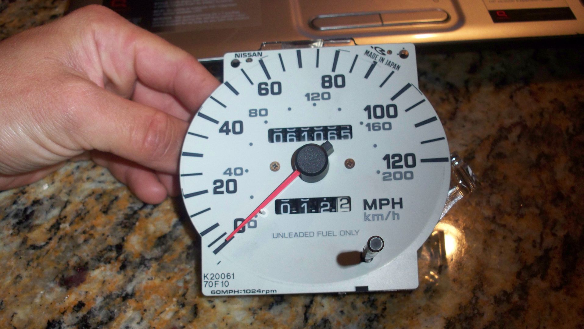

Not only that since i had it apart i readjusted the odometer and now have the lowest mileage s14 in the united states lol.

Ok stock comes soldered from the factory 3,4,5 and 7. Pay attention to what i circle and say in the pictures. NOt the actual picture its just for reference.
Heres a list i put together
This is what i got from my testing, the resistor on j2 needs to be placed no matter what. These are the switches that need to be open or closed.
18s with j30 rear gear
switch 7 soldered
all others open
18s with stock 4.08 rear
switch 7 , and 5 soldered
all others open
17s ie 245/255 35-40 sidewall with stock 4.08 rear
swtich 6, 7 soldered
all others open
stock 4.08 rear with stock wheels and tires 205/55/16
switch 6,7 soldered
all others open
These settings should be pretty spot on, at worst 1-2 mph off. You can fine tune it adding more or less percentage but that should pretty much get you where you need to be.
