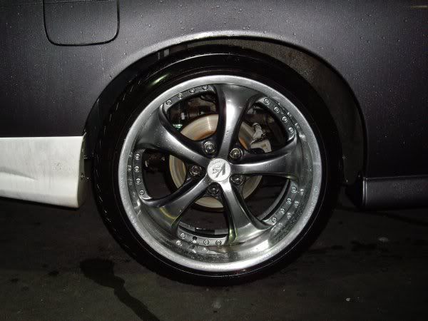

Originally Posted by Fries View Post
What do you mean by in center?
I'm 100% sure my subframe bushings need replaced. Added stress of the twoway be causing the extra movement?
can you see my wheel is set to back more than center?
my sub-frame bushings were shot.. and it was making clunk noise every time I was driving
it needed it to be changed..
