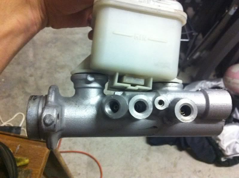

z32 brake master cylinder
does anybody know what size BMC this is? and will i get a good pedal feel with it in my s13?

im pretty sure its z32, i was told it was, lol
and thanks midwest, i'll try those threads!

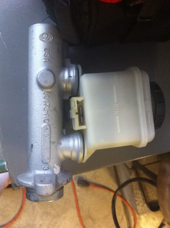

damn yeah i don't see those part numbers anywhere on this BMC, only part number on it is 30173-AC, but can't you tell if its a z32 brake master cylinder by looking at the fittings?

It might be a remanufactured or aftermarket replacement part. try all local parts store for the part number.

found it i guess here's your answer:
Quoted from a different site:
I'm having a similar problem. I have a AC delco reman. 1-1/16
300ZX MC. I took the flair fitting out of my old 240 nabco MC. The fitting doesn't press into my new MC, if I turn it upside down it falls right out. Not sure if the the MC is a tokico or nabco, all it has on it is these two numbers
30173-AC
1028989A
Am I supposed to get the flair fitting from a 240 with a tokic MC?
blktopsr20 is offline   Reply With Quote

From what i found out pedal feel is the same as the oem counterpart of it. Issue is what nipple fitting can go in the center. I guess if you have one pressed in, watch for leaks. Since this bmc was not design to have a 3rd fitting. Goodluck
