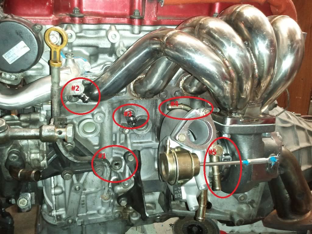

#1 obviously oil line goes to the top of the turbo
#2 coolent return goes to #4?
#3 coolant to the water inlet #5?
#4 coolant out goes to #2?
is this correct and where can i get the lines for this turbo they are stock oil and water lines...... but i want steel braided lines

If you want steel braided lines for the above setup. You need to change the banjo(s) at the turbo to banjo/AN. Then get the metric to AN adaptors for the block side.Now make lines to fitRoute them however you need. DONE

I've got mine like #2 to #5 and #3 to #4. I don't think the coolant passage has a directional flow. What's up with the "RB" tag?

hmmm i need to figure the lines out idk what way eerythinggoes like return ect...
