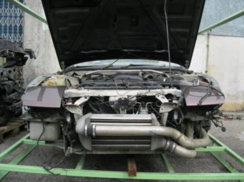

Hi, I have a JDM S14 and have been offered an Apexi Hybrid FMIC.
The guy selling it had it fitted to an S13 Silvia. I know anything is possible and anything can be made to fit, but will this fit the S14 with little or no problems?
I like the idea of it as it will help to keep my car looking stock"ish".

that looks like horrible routing...if you have a killer deal would swap the passenger side end tank with one that routes directly into the throttle body like a normal fmic

Don't waste your time or money... A third of that core is blocked by the piping. Buy a kit designed for the car, it'll save on headaches.

Thanks for the input, it looks like it'd not be a direct fit anyway!
Would have been nice to be able to have used the stock I/C piping!
