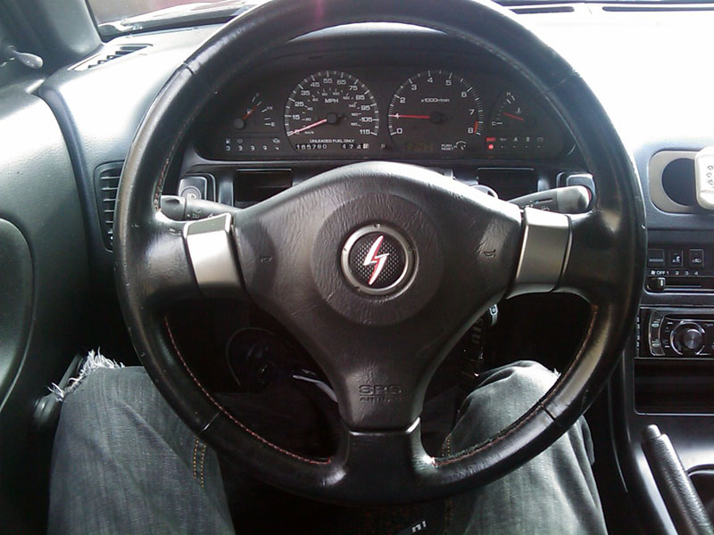

Judging by your temperature gauge needle, you are running a bit too hot. When my car reaches normal operating temp the needle is in between the 2nd and 3rd marker. I've noticed that when it starts creeping up past the 3rd marker the car starts running worse. I don't have an AFR gauge so I can't give you any numbers but in the video your needle is in between the 3rd and 4th marker, too hot IMO.
edit:
Here's my gauge waiting in line at Chik-fil-a... Idle is a little high I think my foot was resting on the throttle when I snapped this picture. Usually it idles around 850rpms.

^hmm, I never pay attention to that needle. I have a aftermarket gauge, shows about 160 in that video. Oil temp is about 160 as well, it's cold in the mornings here and with the oil cooler car runs on the cooler side.
Ah I see, then you are fine. I'm guessing it could be the MAF then. Usually if its O2 or CTS related you'll run richer. Maybe over time the MAF being too close to the turbo damaged it beyond repair. I would try a known working one next.

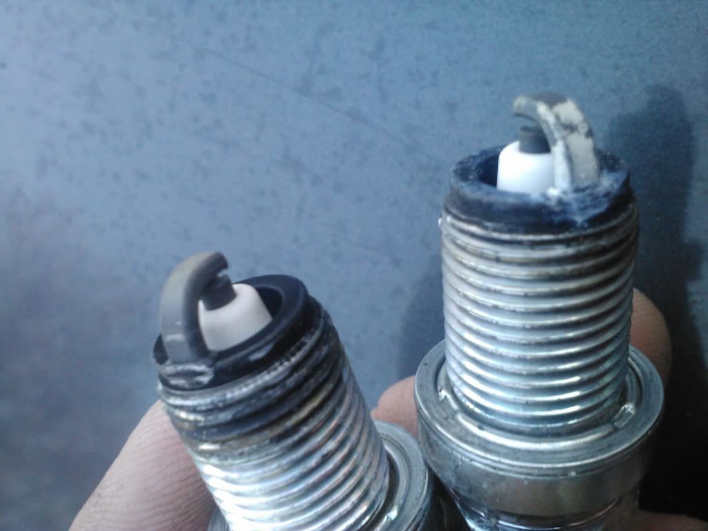

Ok, well the dyno didn't go well at all. Started leaning out hard in higher rpms. I need to back up a bit to make sense of everything for those with the same problems.
First start the engine ran lean, all the time. I thought the stock fpr was bad and installed a nismo fpr.
That didn't change anything.
I found out the maf was too close to the turbo, moved it.
That changed the lean idle to a Intermittent issue.
On the dyno, car ran super lean the whole time, lean in boost, lean idle, tip-in/light throttle sucked. Gave up and went home.
I have a problem letting things go, so I start thinking again.
Put the stock fpr in.
No more lean idle.
Went for a drive, no lean issues at all, then the car dies and won't start. T start to trace wires and find the maf signal wire at the ecu had 1 thread connecting it. I find the ecu connector loose as well.
Drive home happy, get home and find a massive exhaust leak where the DP meets the cat. That explains the dyno's afr's reading leaner than my innovate WB.
Plugs before on the Right, plugs after the Dyno on the Left:
The exhaust leak was making it seem leaner that it was, it was lean, just not THAT lean.
