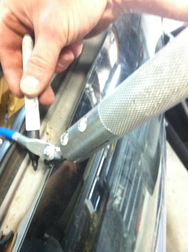

First you need to start by removing the outer weather stripper, Start from the top and door jam side (thinner portion of stripping) and work your way to the bottom first. This will prevent you from tearing your old dry rotted rubber. Run the cold knife along it as so, may need a tad of heat to get it going IN MODERATION or youll melt your shit!

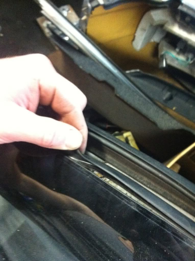

Now you should be able to start pulling it off, use a little heat if its not seperating easily. Heat it and let it cool, the old glue won't want to restick after its been loosening and you dont want to pull on the hot rubber it will rip

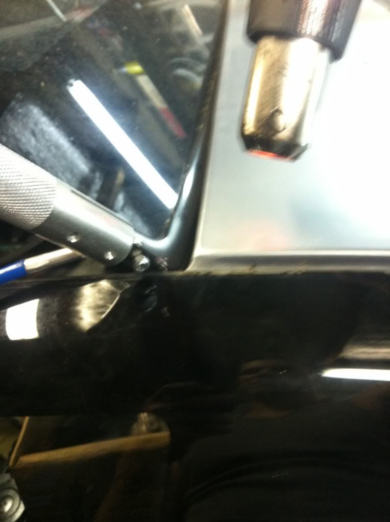

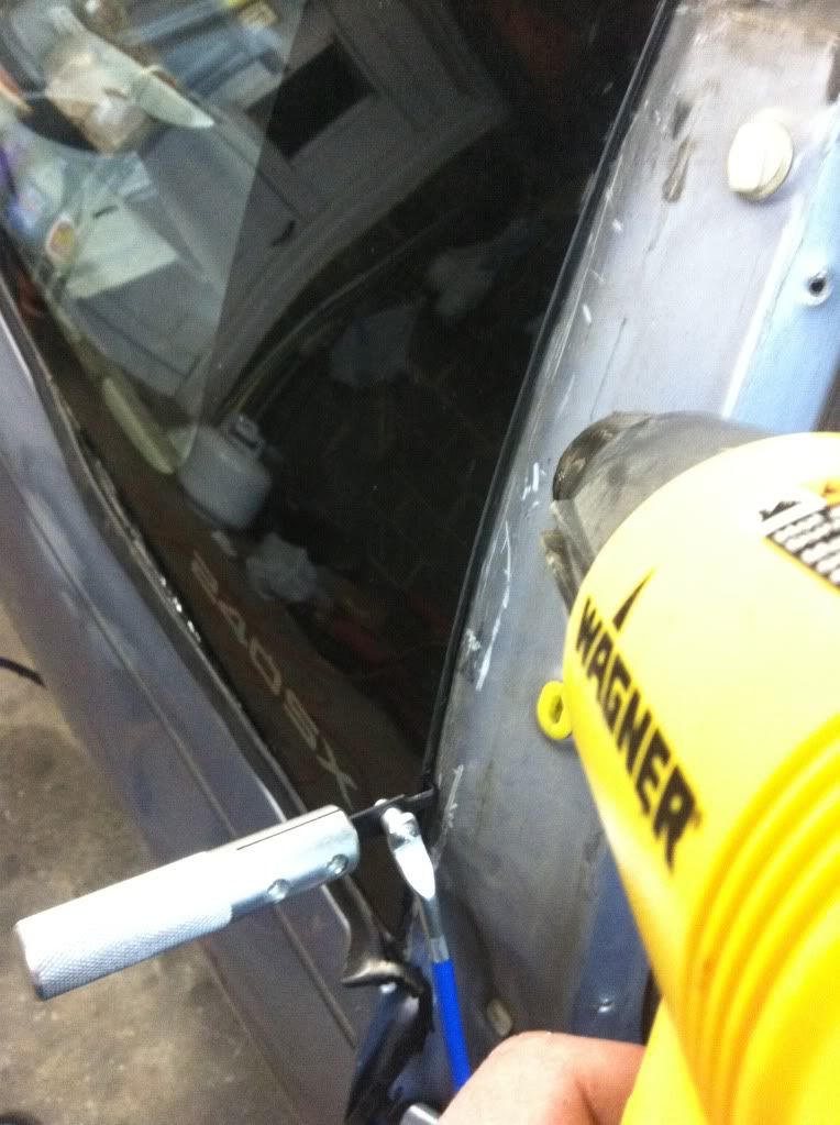

If the bottom is being a bitch (like mine) you start removing the glass itself along the side and top by cutting the adhesive that holds it on to free a little wiggle room. Here your going to need some heat, probably alot of it. heat then cut wile its hot as pictured.

Heating directly in the crack works best because this adhesive is some tough shit!

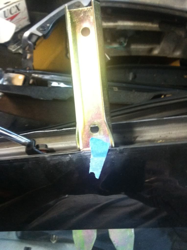

ok so theres also some clips directly glued to window that line the window up, when you get to this point mark the clips (4 Total).

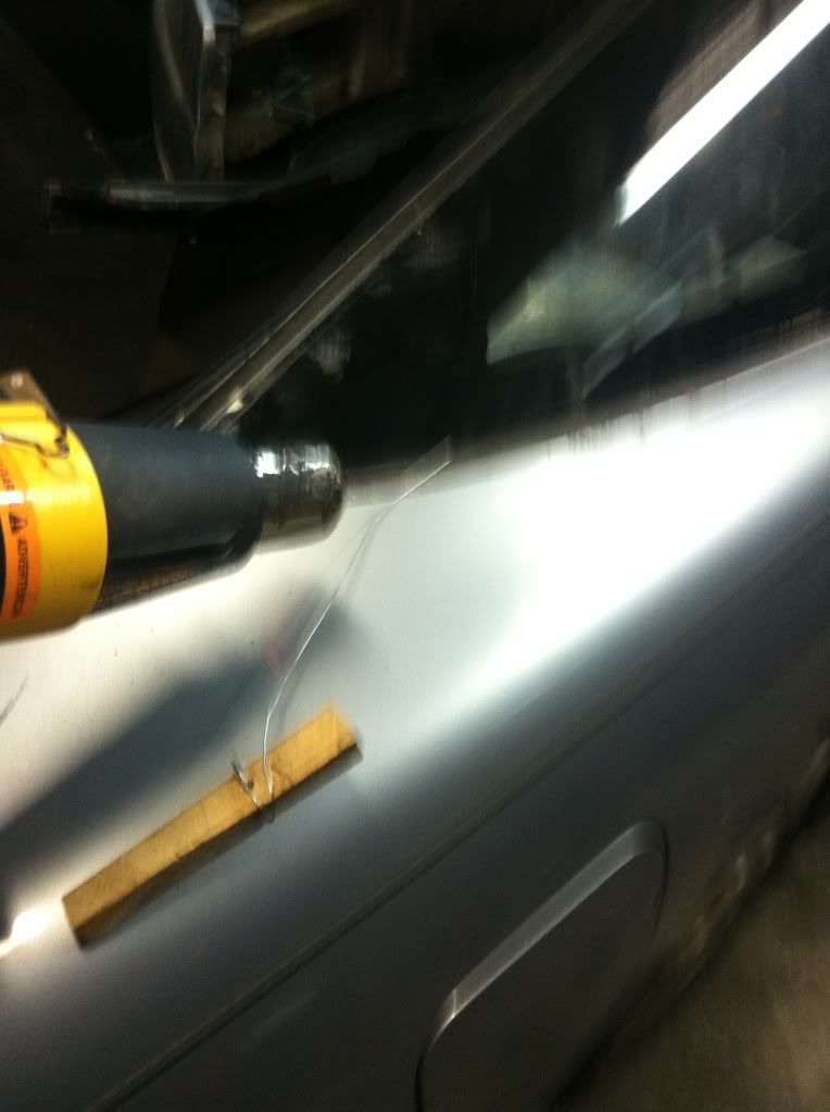

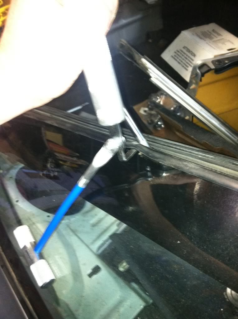

as for the bottom, the cut out tool isn't able to get in the crack. So here is where you bust out your two small blocks of wood and mechanics wire. Drill holes in the wood so the wire doesnt just fall off. Heat a spot at the bottom and feed the wire through with the pliers. Much easier to feed from the back to front not as im doing here

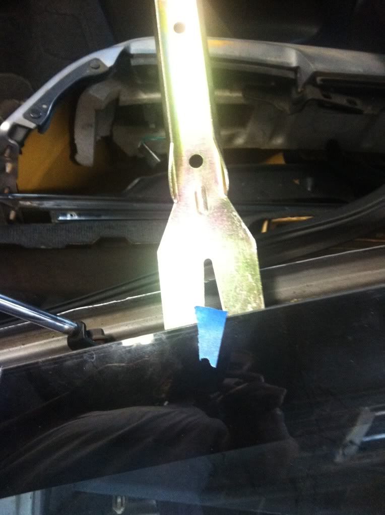

so after you get ALL the adhesive off you can now pop your clips with your clip tool. DO NOT PRY ON GLASS!!! you will break it very easily like I did from the junk yard part, it doesnt take much

Just push the tool all the way down and it will pop the clip. Remember there is 4 of them. DONT FORGOT 10 MM BOLT ON THE INSIDE

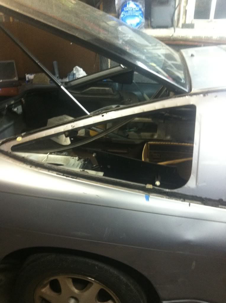

The window should be just about to fall off for easy removal
