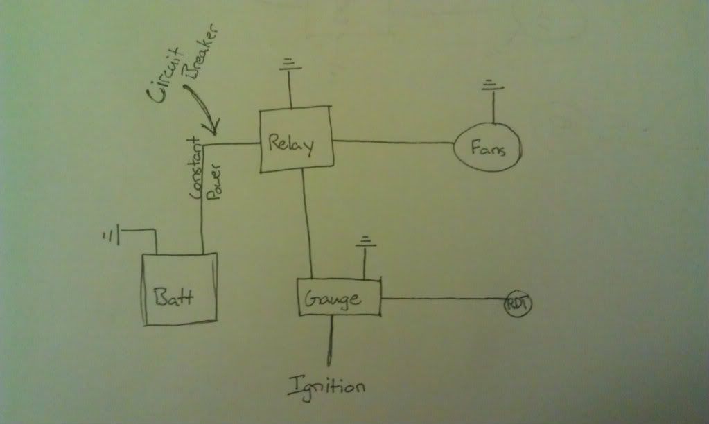

At one point in time I had the fans running off of the fog light wiring (since I don't have fog lights) but they wouldn't turn off with the car and had no problems. Sorry for my erradic train of thought but here's what I'm thinking right now: Have a relay with the constant power input coming from the fog light wiring (where the fans were previously wired to), have the ground from the relay go to.. a ground lol, get one of the previously mentioned gauge/switches and wire it to the ignition, and run the switched power from that to the relay, then the output of the relay would go to the fans. By doing this the relay would always have power, even when the car is off, but it won't actually close until the car is on AND the gauge/switch sends power to the relay... Correct?

Here's my fancy diagram that I came up with in my head.. Anyone's input is welcome, hopefully this helps someone in the future too if it ends up working.
