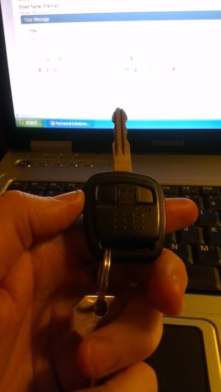

Guys,
I think I can get my central locking system working. I just need to know how to re sync the key. ![]() Car is a jap import and does not have Nats. Cheers |

It should be the same for an S14.
Get in car and lock door using door lock switch. Insert key into ignition 6 times within 10 seconds. Hazards should flash. Turn ignition to ACC and press unlock button on remote. Hazards should flash again. Turn ignition to off, open then shut door. |
