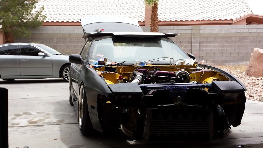

a pic to show and floss
wired correctly
searched but no one has a answer after there thread its booty
