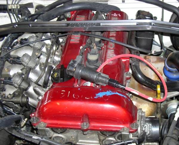

Im not sure that will give you a proper reading. A common method, which has worked for me and many others, is to get an old spark plug wire and cut the portion of it that plugs into a distributor off... Stick that end in to the coil pack(part that goes over spark plug), and then plug the wire in to the spark plug. And take the reading from that.

Just like this

Ahh okay I see thanks guys this has been eye opening as far as timing goes, big help!

And also, I did what javi mentioned earlier with sticking a sparkplug wire into the coil so that you can get an "accurate" signal by clamping your timing gun onto.
That was the only way we could get a timing light to work on my friend's SR. It's odd though, because on my SR, the timing light works from both the loop at the back of the head and the wire right at coil 1, I think I even had the induction pickup around all three wires. Same light was used on both motors that both have stock ignition system.

I didn't have to cut anything from the spark plug wire in order to attach it to the coil. I ended up peeling back the rubber boot from where the spark plug wire is connected to a distributor and shove it into the coil
