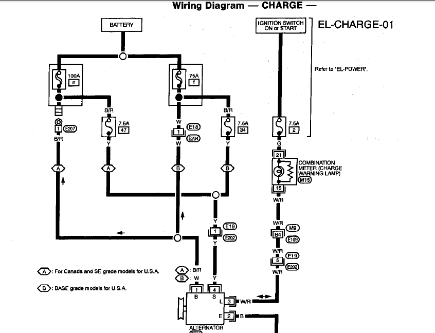

The charge warning lamp circuit must be functional for the alternator to charge. If your 7.5 amp 'gauges' fuse is blown or the charge warning bulb is broken, the alternator will remain offline. Check the fuse and the bulb. Double check all your lower harness to fusebox connectors are properly plugged in.

The engine bay fusebox is the only 'common point' for your non-working electronics. Did you connect the large white alternator feed wire to the fusebox? Did you connect the dual Red/White battery feed cables to the fusebox? Is your battery in good condition? A crap battery could be causing these issues.
A multimeter or test light and the Electrical section of the FSM are important tools needed to diagnose electrical problems.

I had the same problem, the 75amp alternator fuse blew because my alternator was bad, I just replaced the fuse thinking everything was good when I was really driving around killing my optima battery, so I ended up have to get my alternator rebuilt and my battery replaced in addition to changing the fuse, so if the fuse blew odds are your alternator is bad, only thing puzzling me is when that fuse blows all the problems you are experiencing take place, but as soon as you replace that fuse everything should operate properly, until your battery dies anyway, or the fuse blows again, check that fuse see if it didn't blow again
