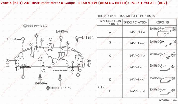

i'll be scooping up some of those LEDs soon, thanks for the link to the website.
edit:
courtesyparts.com
use this as a guideline in ordering the correct aftermarket cluster bulbs.
