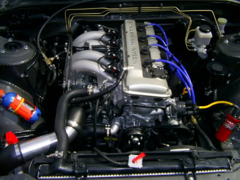

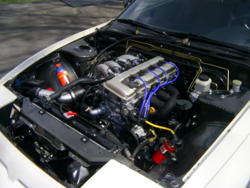

here is an update since i havent updated it in a while..
well i got it running and we had some problems with the coolant. turns out it was getting compression form the cylinder in the coolant.. which meant 1 of 2 things..
1. head or block is cracked
2. headgasket problems
so we tore back into it and found that since our head and block had been shaved to min, 2 of the head bolts had been bottomed out and stretched the threads. this made it so the head wasnt pulled down as tight as it needed to be. so im getting head bolts and a headgasket tomorrow and the head is going back on.
i was just hopeing for autox sunday.. but because of this i will just be spectating again...

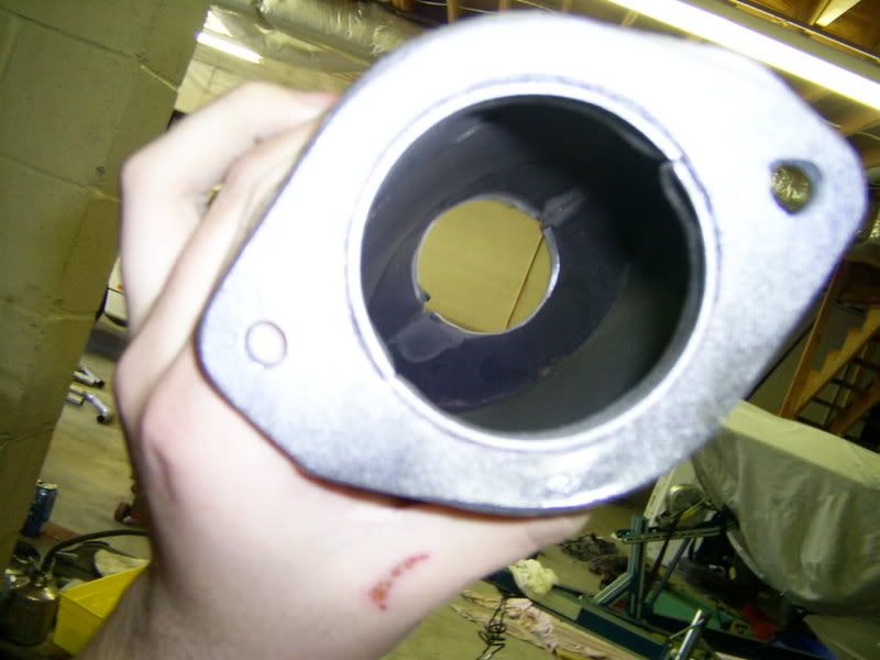

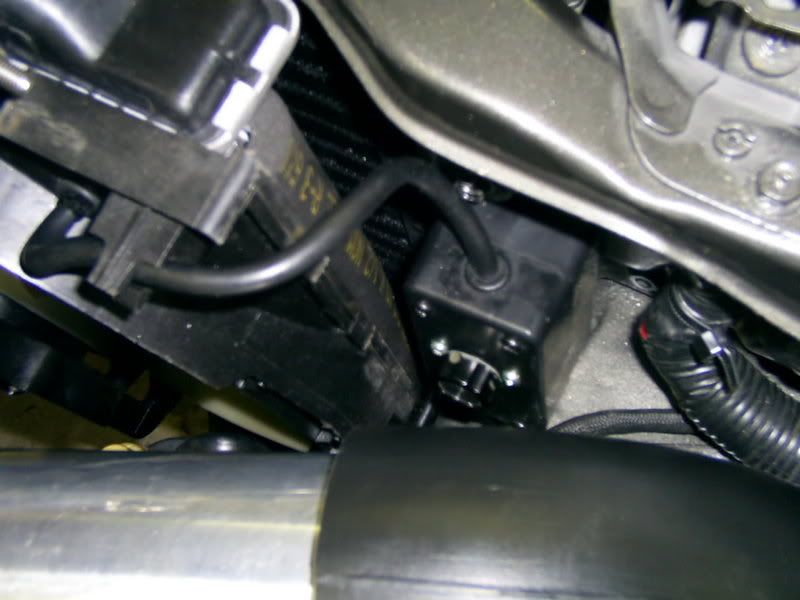

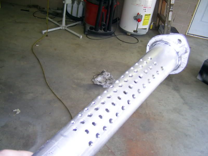

here is our cat turned into a resonator..
here is the exhuast..

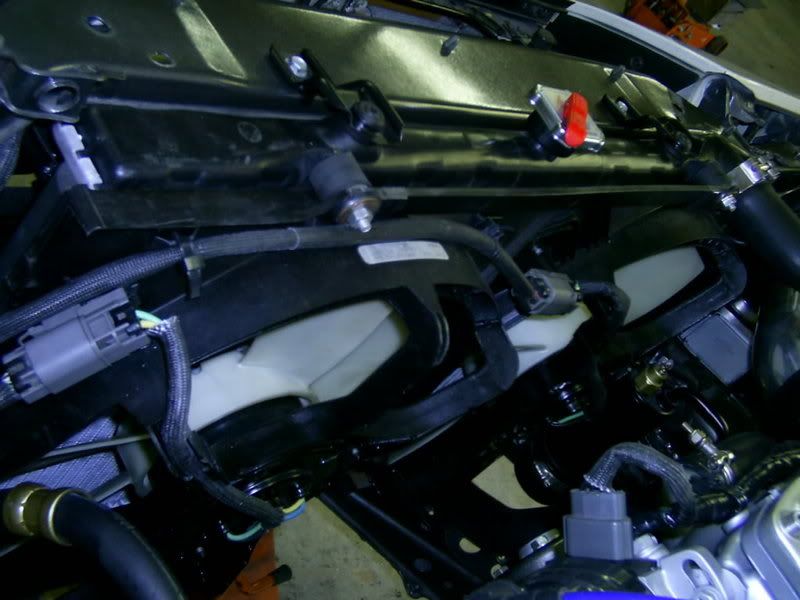

fan controller..

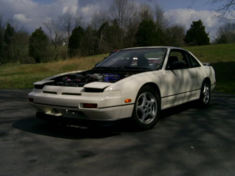

oh something i forgot to mention is.. the next thing for this car before the super charger will be a complete suspension build..
including...
koni 8610/gc sleeve setup
s14 rear subframe conversion (solid mounts)
z32 rear uprights (maybe with spherical bearing inserts)
all aftermarket suspension arms.
and other random things..
