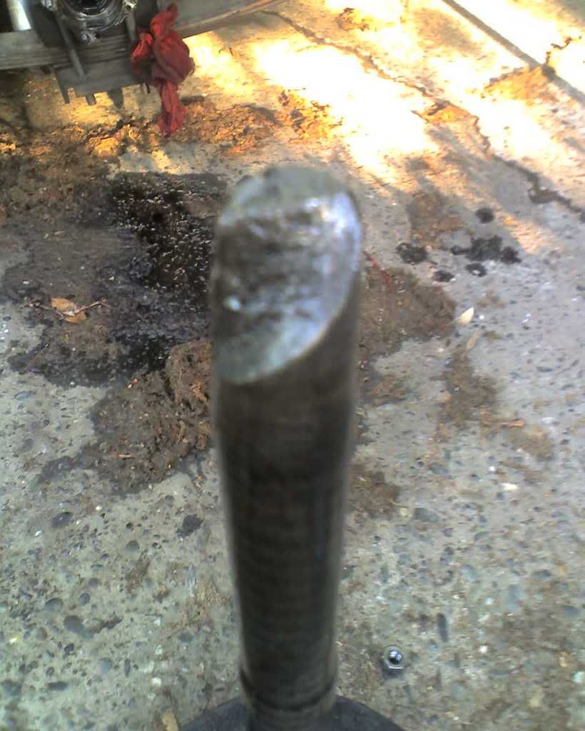

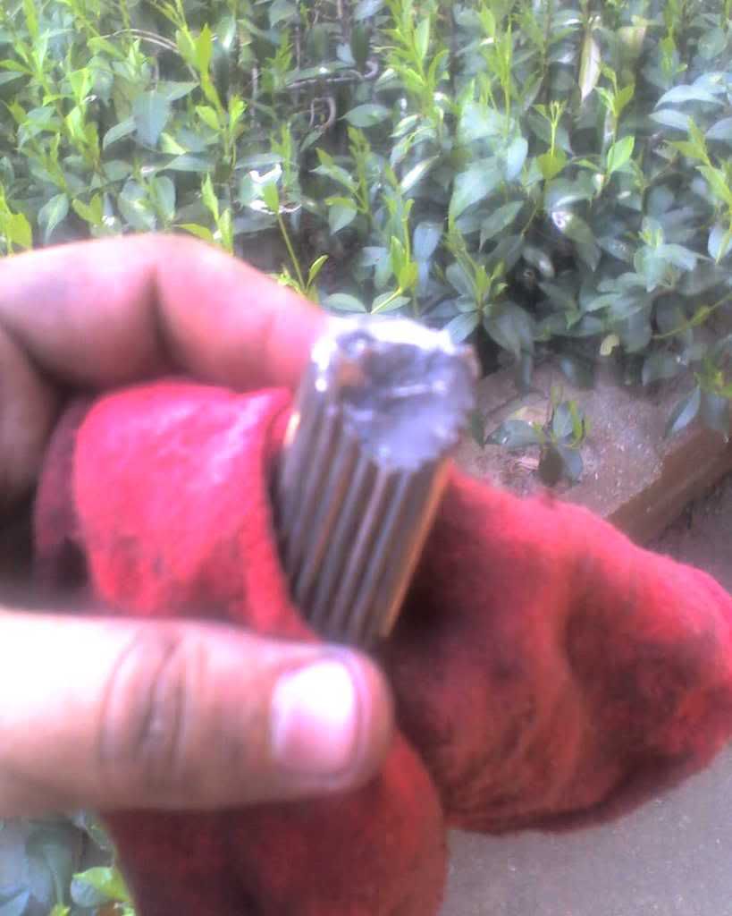

Okay, so yesterday, I FINALLY got around to putting in the new axle shaft. I've had an old, weather-worn, rusty, corroded axle shaft sitting in the side yard for about a month and a half to replace the one I shattered trying to do donuts, as video documented a few posts back. I go to Phil's for guidance, clean up the old one and look up in the book how to change axle shafts.... So I broke the driver's side, and the shaft/backing plate are from the passenger side, so I really needed to swap backing plates and put a new bearing on to make it work. Umm, right...
The book says "If the wheel bearing needs to be replaced, please leave this job to your local Datsun garage, as a new bearing will take between 4 and 5 tons of pressure to seat it correctly." Great, this was going well... After debating in my head for a few minutes, Phil and I decided to say fuck it, reuse a 30something year old wheel bearing that is filthy as shit (though it spun relatively well, considering!), and just run the backing plate upside down. I didn't care anymore.
Luckily, the correct way to remove the broken splines on the axle shaft was easy enough... You just remove both axle shafts, undo the drive shaft, pull off the front of the differential, remove its guts and take out the broken piece that's stuck in there. This job gets better and better, right?
To hell with the correct way, I got a telescoping magnet and removed the broken axle shaft so I could stick it in there and retrieve that piece like you score a pair of keys you dropped in the sewer drain with a stick and bubble gum.... Except that the magnet wasn't strong enough to pull it free. More issues! I removed the other axle shaft and we had to poke through the other side to pop it free of the diff to drag it back through with my magnet. But finally, I had the axle shaft AND the broken splines out, and I could worry about putting everything back together.
Fuck drum brakes, by the way. As Phil brought up, why the hell did we invent drum brakes first? The engineering behind them is way more difficult than disk brakes. They're heavy, hard to work on and they suck teet. Anyway, I hooked everything back up, we bled the brakes and surprisingly, the car felt exactly the same under braking as it did before I used the wrong-side backing plate. Fuck it, I'll roll like this for a while, until I get access and time to be able to use a bearing press and fix it for good.
Anyways, on to the pictures:
Axle shaft, splines are completely ground down at the end from driving with it broken and wobbling around inside. No biggie:
Splines are bent from the stress caused before it broke... I'll turn this into a key chain!
So it's not obvious from the pictures, really, but there's quite a large chunk missing from this equation. Holding the splines to the shaft shows a big piece that isn't there.... The metallic color of the oil inside my axle hints that it got ground into powder... So I won't worry about it, it hasn't caused problems yet, right?
So yeah, does anybody in NorCal have a bearing press and an afternoon to spend fixing my axle correctly? LOL!
I have talked to some 510 gurus, and they suggest that the wagon axle can actually hold up to some pounding with upwards of 200-250hp at the wheels... This leads me to believe that the fact that my leaf springs are flimsy and I have 2.5" blocks in the rear, giving enough leverage to cause some severe axle-wrap put way more stress on the shafts than is normal for the power I'm putting down... I need to get some new leaf springs/have mine stiffened and de-arched to get ride height corrected without blocks. Hopefully I'll be able to do that within the next month or so, I just need to see if Chris is willing to let me borrow some leaf springs, or if I can buy them fo' cheepz!!

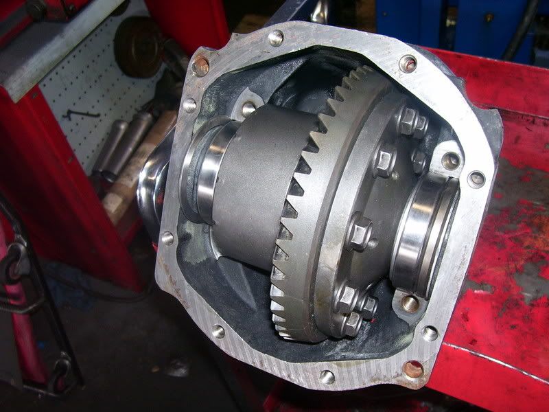

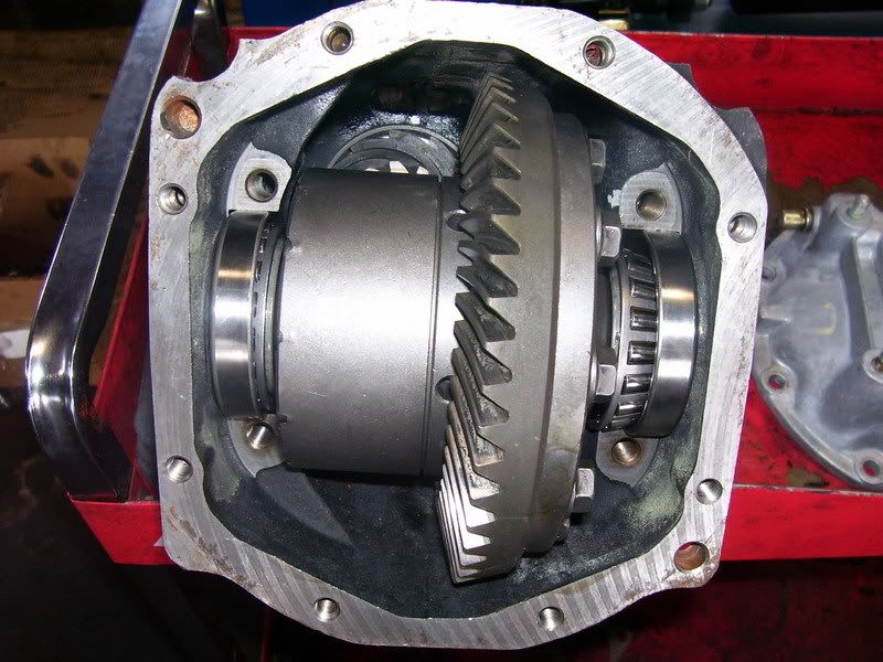

Subaru differential is the best upgrade for the 510 coupes. The ford 8.8 diff is the best to use for the wagons once you shorten the axle shafts very durable for a lot of power.

Yeah, I'd be going with a Ford 8.8 from a turbo thunderbird, because they had some badass gearing and disk brakes. But I don't have money to drop on it yet, I'll hold off until I go KA-T.

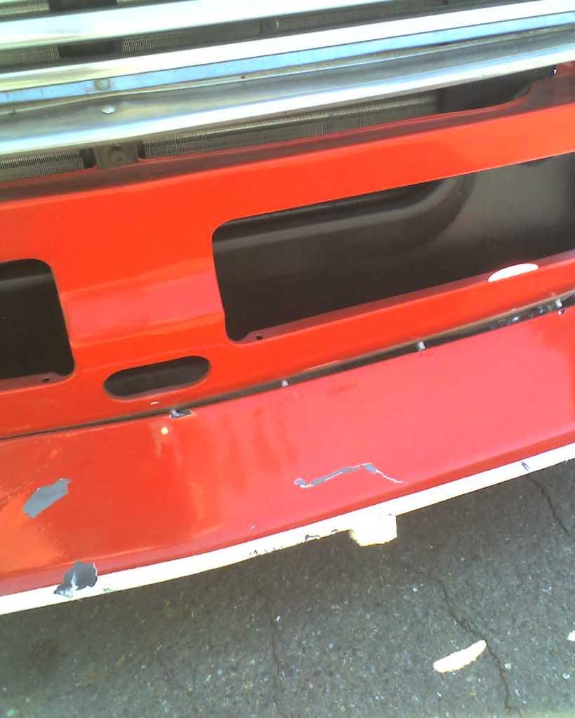

Piss In My Aaasssss!!!
People fucking suck. Such is the lesson life taught me today. I go through the day like usual, even making use of my tax return to buy a coolant reservoir that I may or may not return and get a smaller, cheaper one, even though it fits in there nice and snug.
The day started out normal, waking up, deciding that since I showered yesterday before work, I wasn't going to shower this morning, and leaving for school. Mind you, the Datsun is not yet my daily driver, and it still sputters and dies, more often when I stop hard or turn under deceleration. Until I fix those issues, I won't bring it to a community college, I'll leave it out front of my parents' quiet house in a nice neighborhood. Or so I thought.
When I got home, I came from the opposite direction from where I left, meaning I was coming toward the front of the Datsun. My heart sunk. I saw that the chin spoiler, or Spook spoiler, was hanging off the valance and was missing paint. After parking and walking up, I see that all but 3 rivets were torn from the fiberglass and the lip itself was torn almost completely in half and was pretty beat up all together.. I had to force the rivets back through my broken spoiler, drill holes in this $150 piece and run zip ties just to hold it onto my car..
I'm not a happy camper.
But on a plus side, I did get the car aligned and the sensors said that I had 3.5* negative camber! And the caster wasn't too far off from where he'd usually set it, so we just adjusted the toe and called it a day. Now the yellow line pointing up on my steering wheel means that I'm going straight, not left! Yay me!
I'll add more pictures later, that was my 'I'm sad and hurt' photo.
