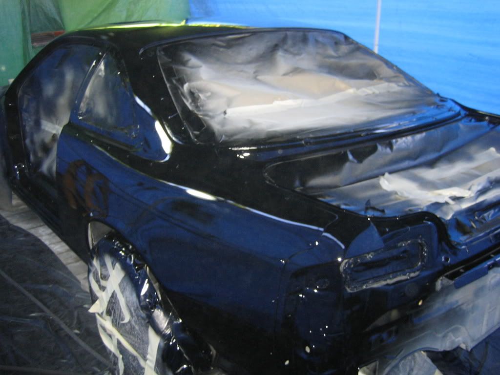

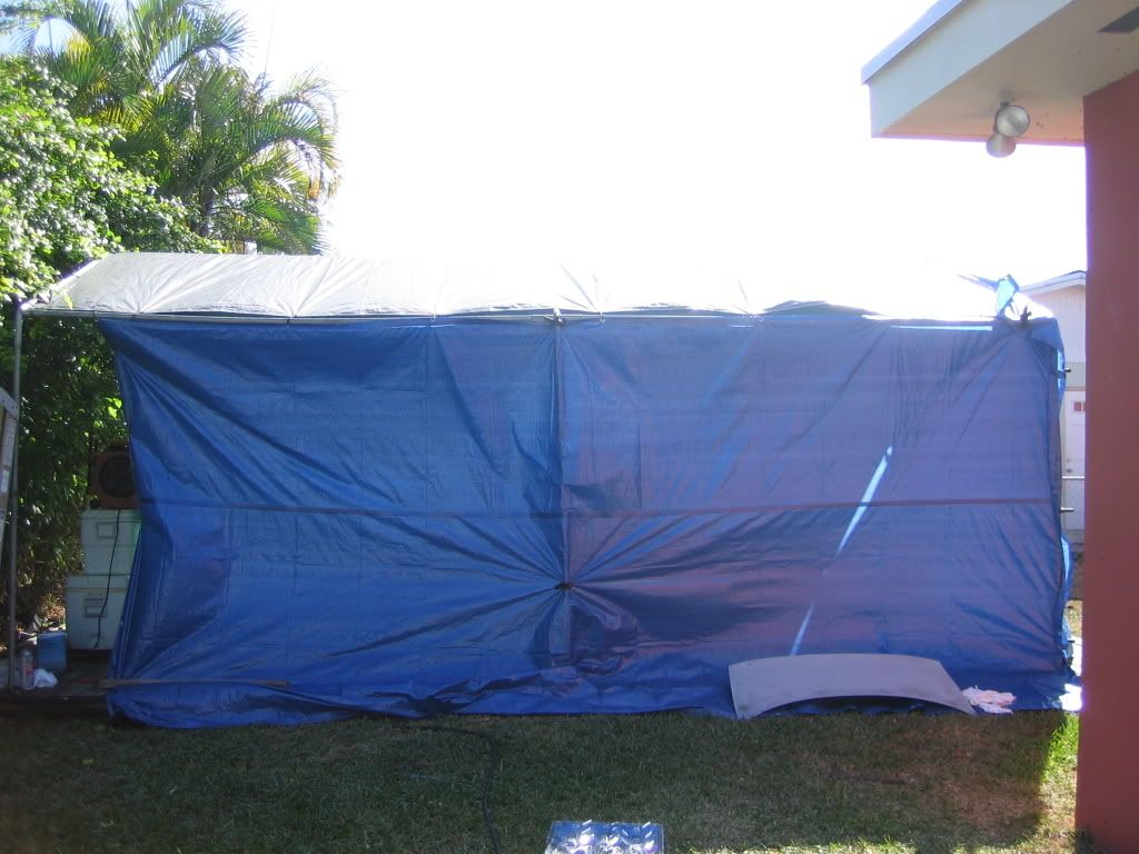

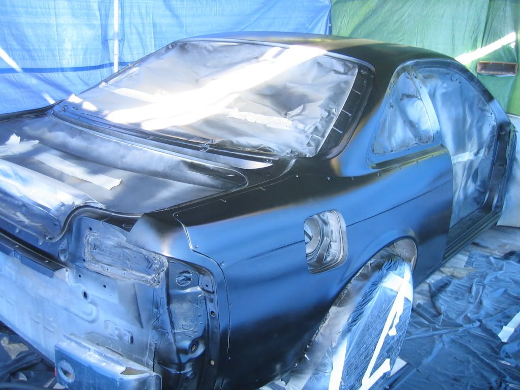

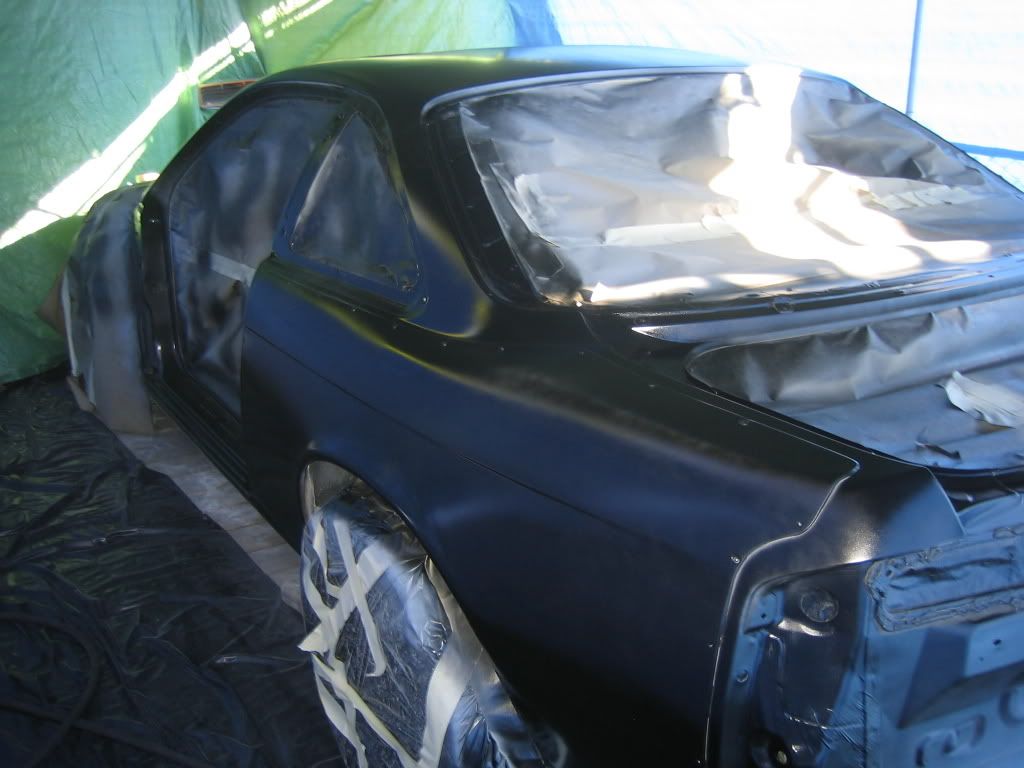

Ok well here goes

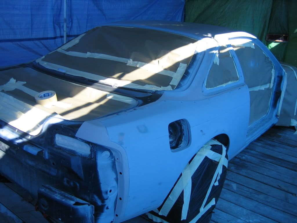

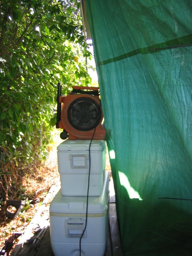

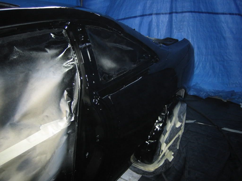

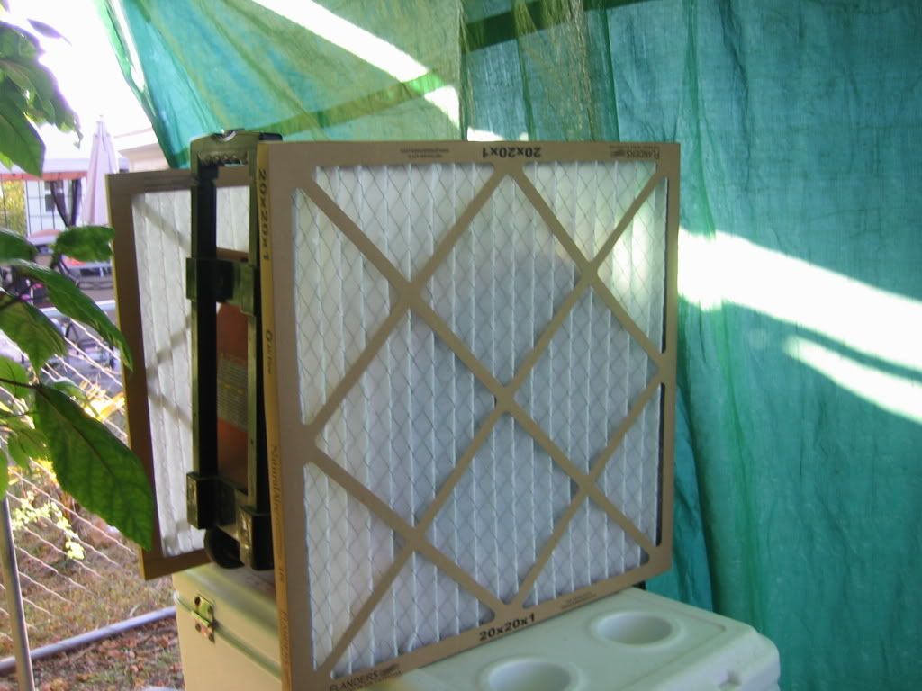

Woke up this morning and built a spray booth.
Got a fan with a filter to blow in fresh air

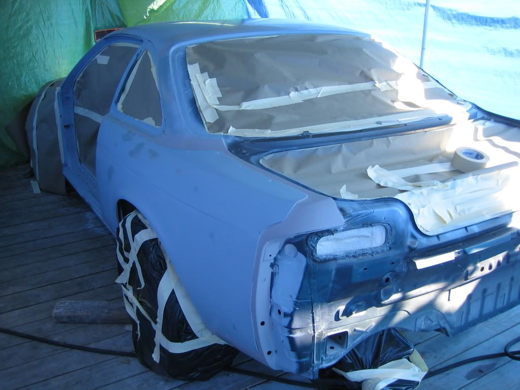

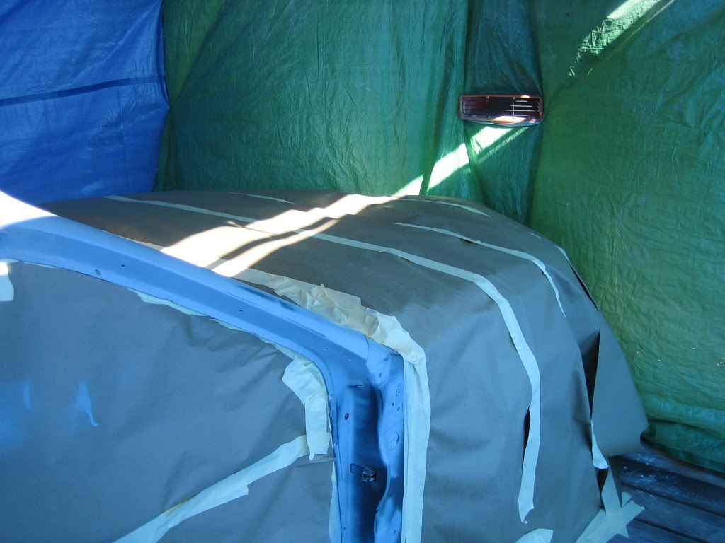

Here is the before, it took almost 1.5 hours to tape this car up, i hated it lol...

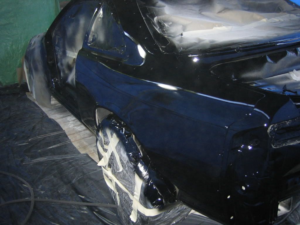

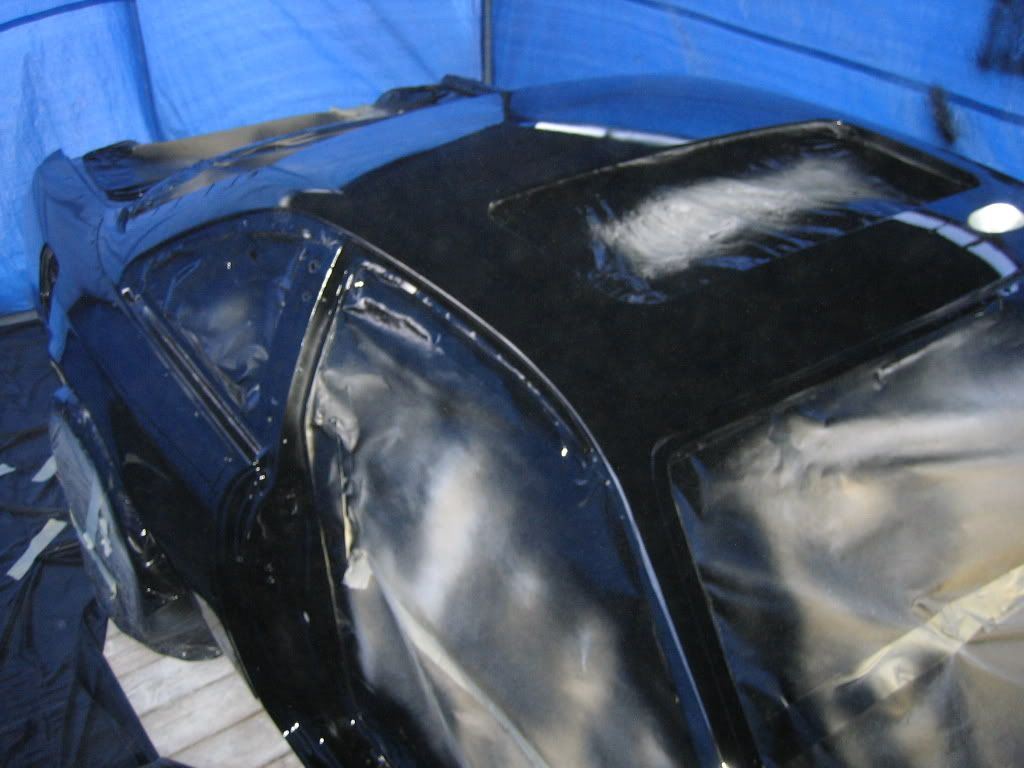

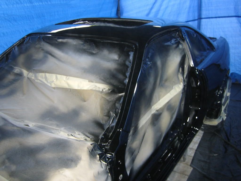

Gave it a coat of sealer
1st thru 3rd coat of jet black
1st coat of clear

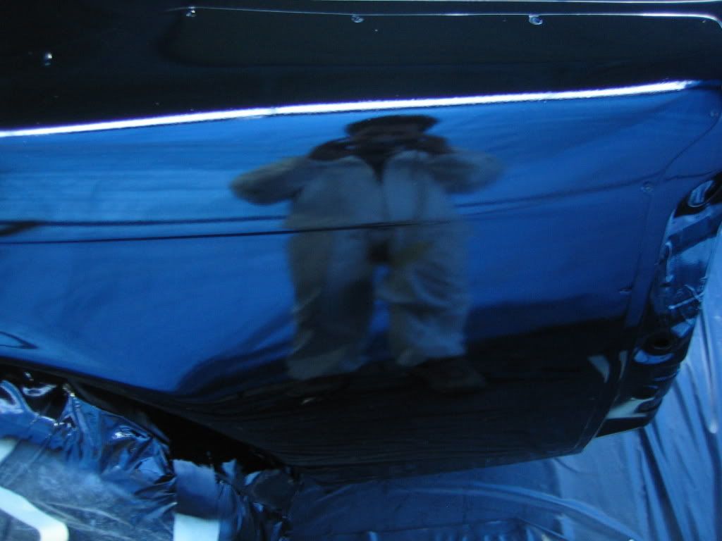

2nd and 3rd coat of clear
Thanks for looking

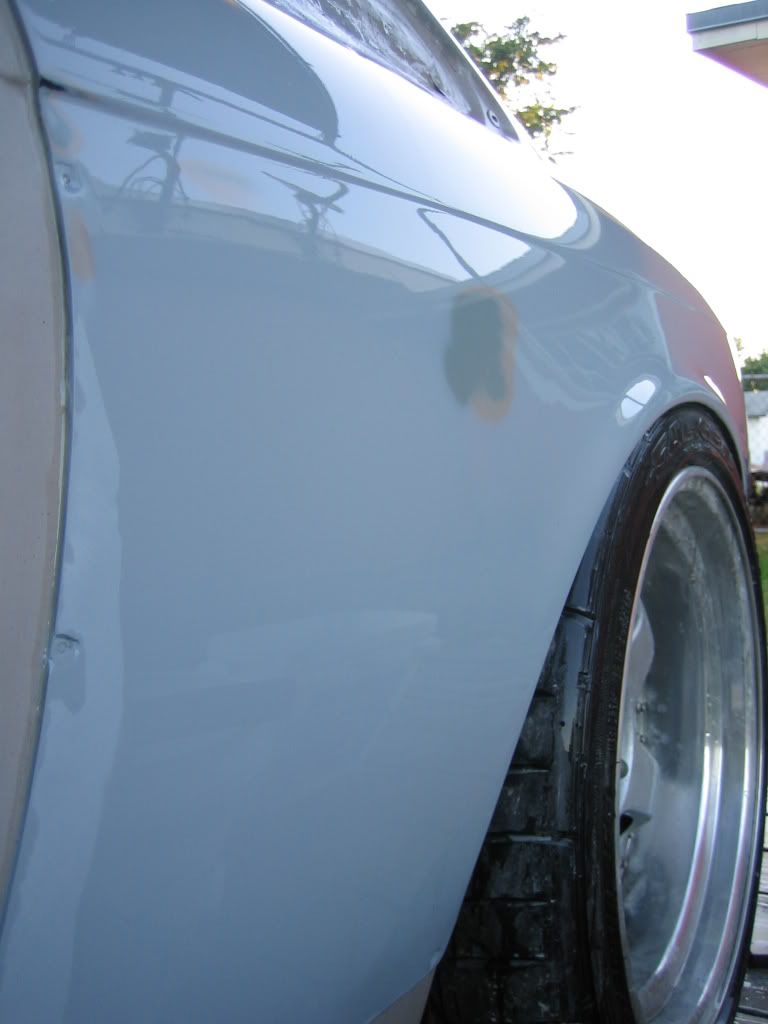

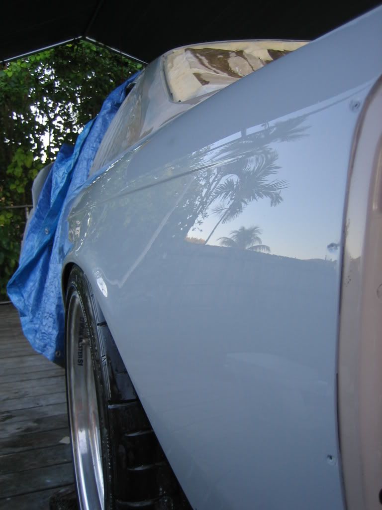

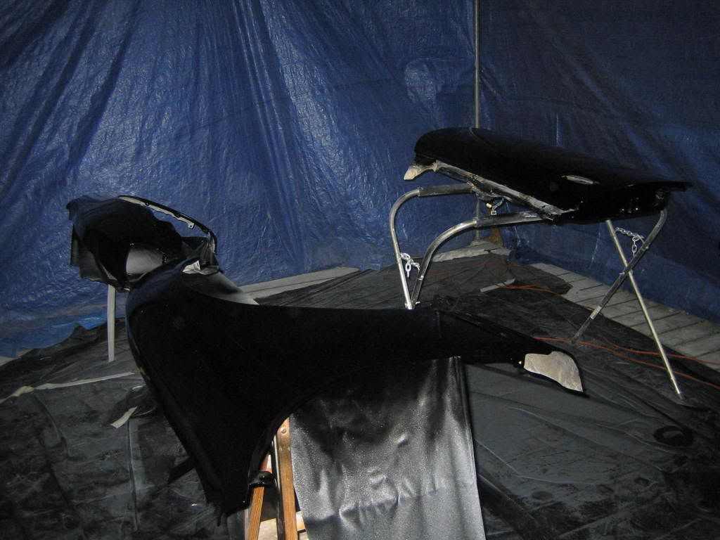

gsracer has a reputation beyond reputegsracer has a reputation beyond reputegsracer has a reputation beyond reputegsracer has a reputation beyond reputegsracer has a reputation beyond reputegsracer has a reputation beyond reputegsracer has a reputation beyond reputegsracer has a reputation beyond reputegsracer has a reputation beyond reputegsracer has a reputation beyond reputegsracer has a reputation beyond repute

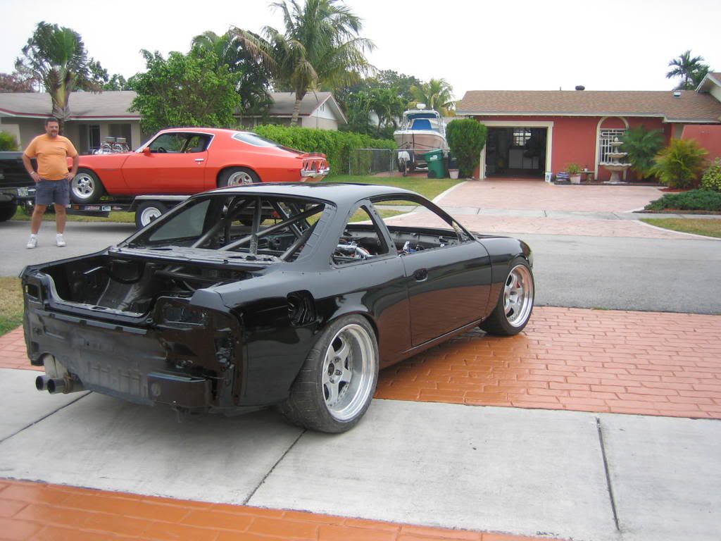

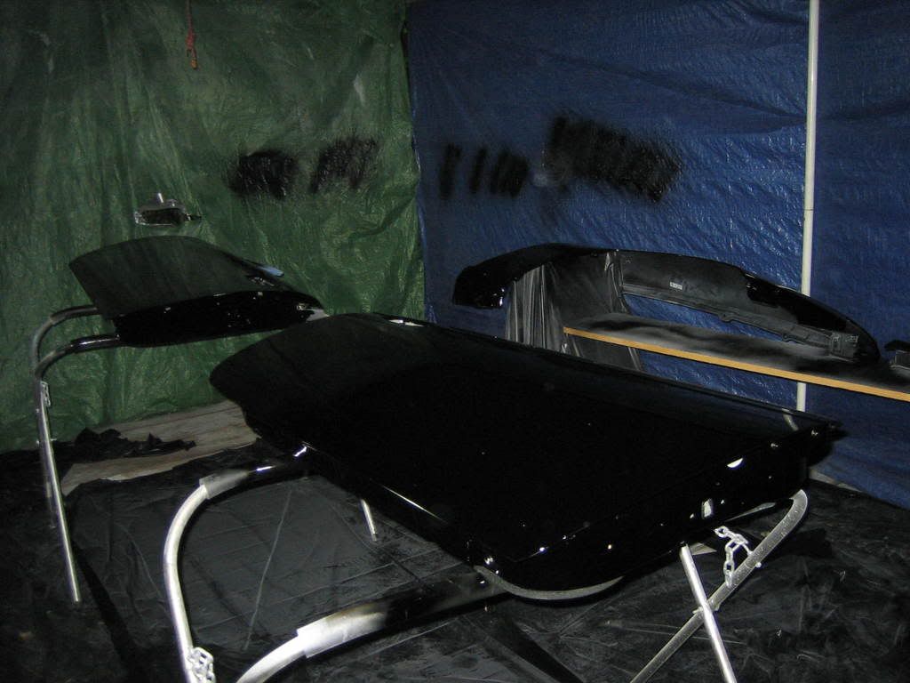

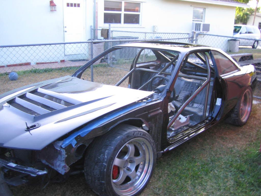

pushed the car out for a bit today, no sun at the time overcast but heres the pics
Also got the fenders and doors done as well...

Heres some pics

Originally Posted by gsracer View Post
Is he eyeing your car from a future competition standpoint? "my camaro will smoke your POS" haha
Car looks good man

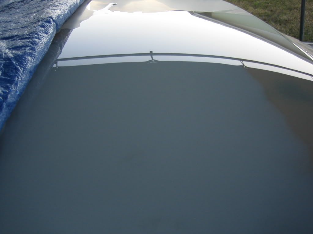

Started some of the wet sanding and buffing today
mirror? you decide..

was that supposed to be a flat finish?
waay too much dryspray. You're either holding the gun too far away, or you're moving too quickly. Also, watch your overlap...its hard to see from the pics but your hood may be sporting some bad tiger stripes. How many coats of clear did you give it?
I saw some guys asking about primer guns, I'm a fan of the GTI primer guns, and I usually use a SATA HVLP 3000 for base/clear (1.3 spray nozzle on average, every paint manufacturer has a tip size they recommend) . Or sometimes a SATA Jet 3000 RP for clear, that gun lays clear on nice and smooth, You just have to be a little bit quicker with your pace when using the RP +clear.
