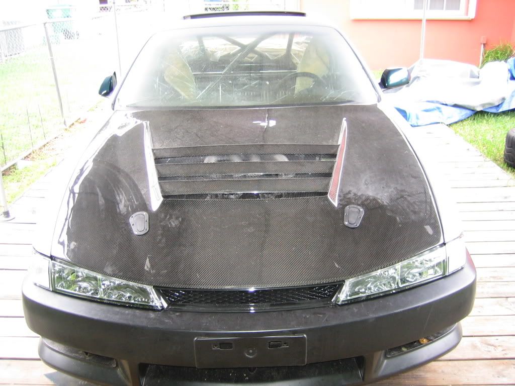

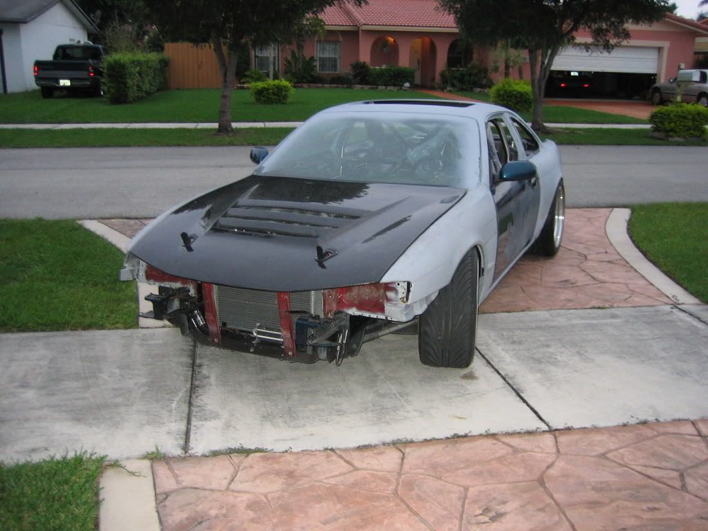

Old 10-26-2008, 06:57 PM   #16
gsracer
Location: Miami
Posts: 1,590
gsracer has a reputation beyond reputegsracer has a reputation beyond reputegsracer has a reputation beyond reputegsracer has a reputation beyond reputegsracer has a reputation beyond reputegsracer has a reputation beyond reputegsracer has a reputation beyond reputegsracer has a reputation beyond reputegsracer has a reputation beyond reputegsracer has a reputation beyond reputegsracer has a reputation beyond repute

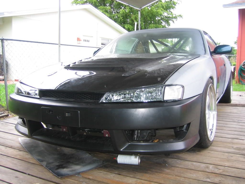

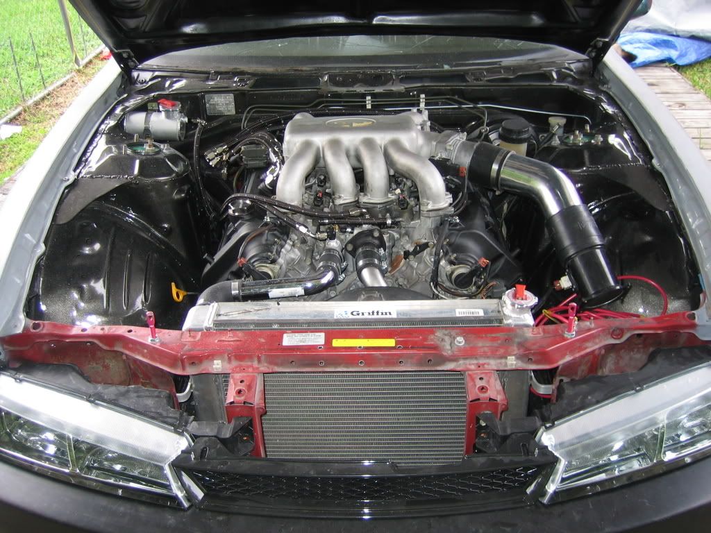

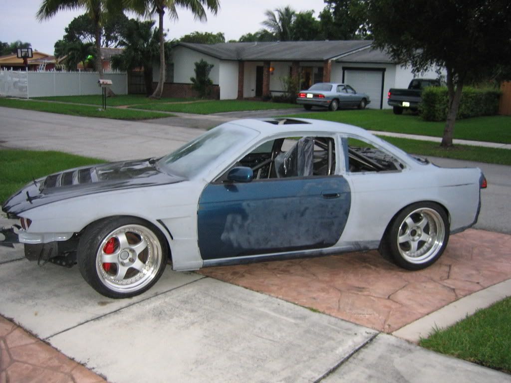

Well busy weekend, got the front end mocked up and hood pins installed and pretty much got eberything mechanical wise put together.
Which culminated in this
YouTube - VH45de S14 first drive again 2008
The whine you hear is the p/s pump as i had no fluid in the system,
We ended up removing everything that wasnt bolted down and took it for a spin, unfortunatly the vid is pretty uneventful. When i was further from my neighborhood i opened her up, it will destroy 315 azenis from a roll in second gear and if you go first thru third its amazing, i couldnt take it out too long as it was getting dark, but all in all great ride
Heres some more pics
Serious buisness
ANTI-STRETCH NAZI
Vortech Supercharged Vh45de S14 V8nissans.com
gsracer is offline   Reply With Quote

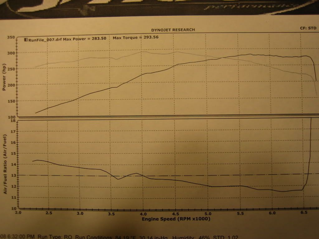

Well made it to the dyno today, did a couple of pulls with a few different tunes courtesy of mazworx.
1st pull base line, headers / exhaust
2nd pull left the vtc till redline no other changes, picked up a few hp up top tq remained the same
3rd pull vtc was stock a few degrees of timing and a little leaner
Big diference in tq below 4000. Best pull of the the night.
So the most power was 283hp 293wtq. I think with a little more fine tuning 300whp 300lbft tq is very achievable, we shall see. Ill have the .drf's tommorow and can over lay the 3 on winpep.

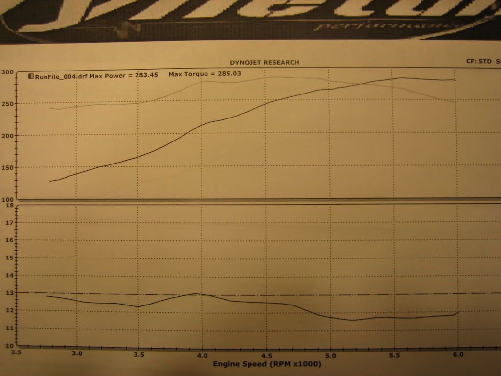

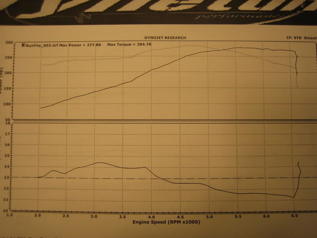

Got the files and better graphs today, just for fun heres the new motor baseline vs my original setup basiclly 100kmile motor (red) vs 227kmile motor (blue). Much better to start with.
Heres the baseline pull (blue) vs the vtc turned off ( red) made about an 8hp increase up top. This new motor is running a little rich for some reason, dont know if the wideband from the dyno was good though, got to check a few things on the engine.
This is a tune with timing and fuel made the best increases down low almost 40lbft of tq below 4000rpm.
