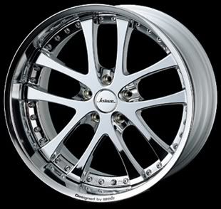

I keep thinking if I get a daily again I'm going to have to fire up the tig and make some turbo headers haha.

^^^ These and Daily this car slammed. Pleaseee. hahaha Keep the other wheels for track beating.

he dont live in FL like we do, im sure dailying a slammed car is much harder anywhere else... hahaha we have such nice, flat, well paved roads here!
BUT I DO AGREE WITH HIM LOL!!!

I think with a little careful driving and making sure he uses roads he knows are flat and pleasant, he should be okay. =]
