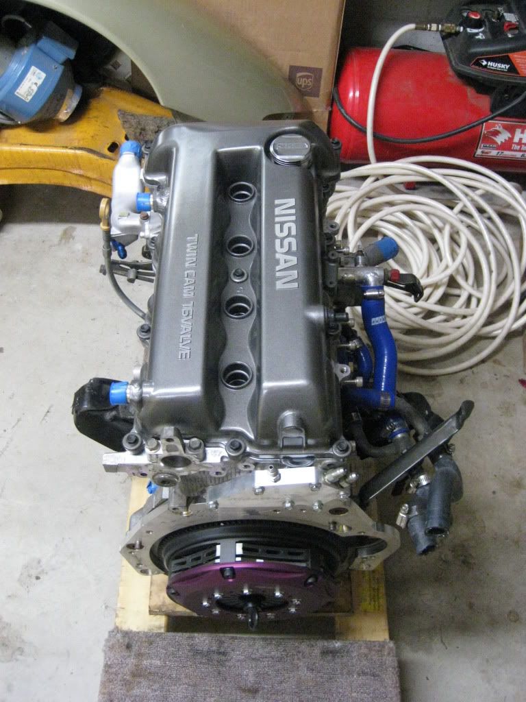

Based on Nissan parts diagrams I've seen it's just a "radiator" if you will, with no specific inlet outlet. But being that I have the exact year and had an S14 SR in my car I should know. I know how my setup is routed with the S14 hoses. I'll see if I can dig up a picture of them.
Old 02-23-2012, 05:42 PM   #10
jr_ss
Location: Pa
Posts: 6,415
In that picture the outside line, which comes from the water pump/thermo housing area, goes to the top port on my car. The inside line comes from the head and connects to the bottom port. This is how I had it setup with my S14 SR and I never had an issue with heat, not that I have to use it too often being in Florida. Hope that helps.
