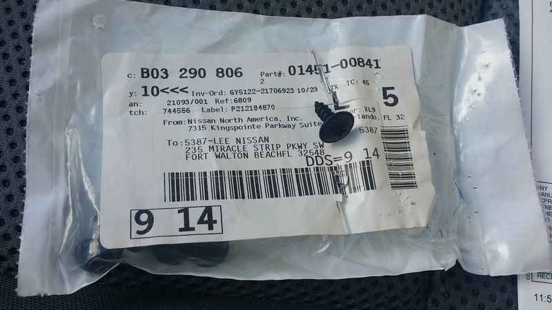

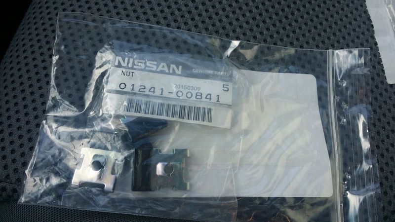

Just ordered hardware from local Nissan
01241-00841: x4 @ $2.69 each dealership
01281-00831: $15 for a box on ebay
01451-00841: x8 @ $1.20 each dealership
Ill post up pics once installed.

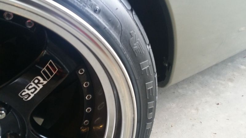

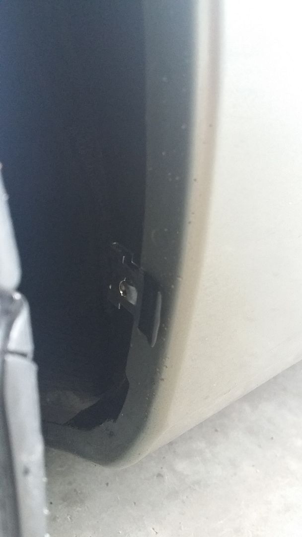

Picked them up from the dealership today.....
Slapped on a clip in rear fender well to test for fitment. Won't know the true test until I try putting on my sideskirt later lol
Yes, the clip is backwards lol....just wanted to see fitment and where they went.
Sent from my SM-N900V using Tapatalk
