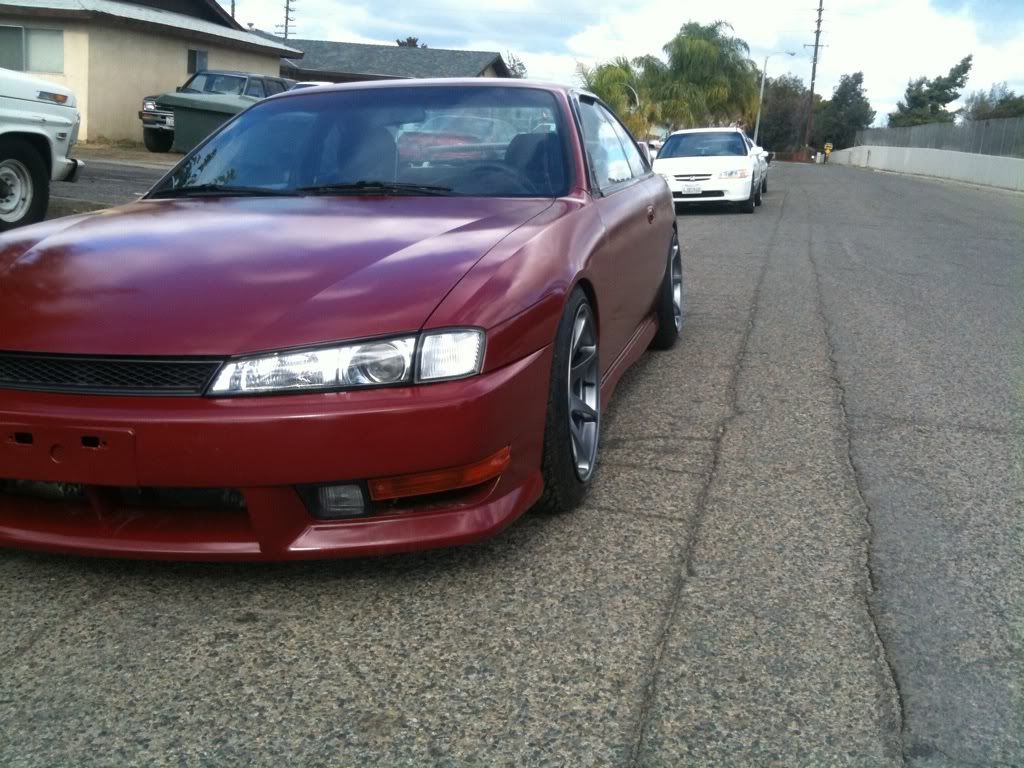

i usually hate the z31's but yours is fucking amazing

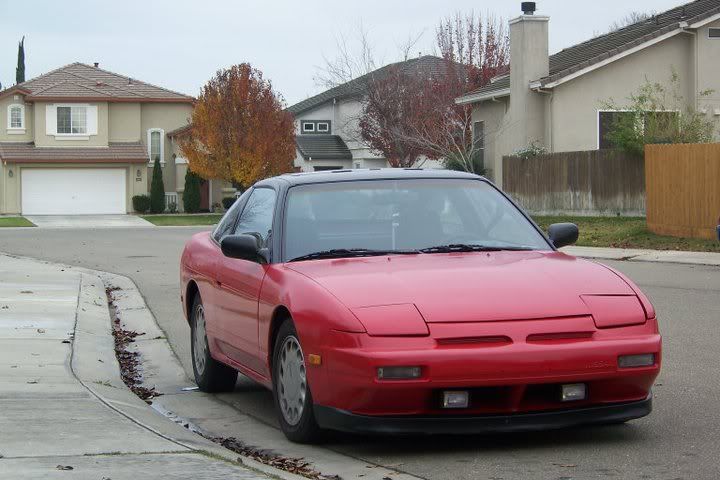

Heres some piks of my rattle-can paint job. only reason i did it was because at the moment i didn't have enough money for a real paint job and my car was multi colored.. red bumper, hood, and half the fender was red and the other half was blue and the rest of the body was primered black.. all in all i'm satisfied with my $30 paint job.
My brother is a painter so he's gona paint the whole car for me in the next month or two.. when i have enough to buy good clear coat. til then.. this will do
