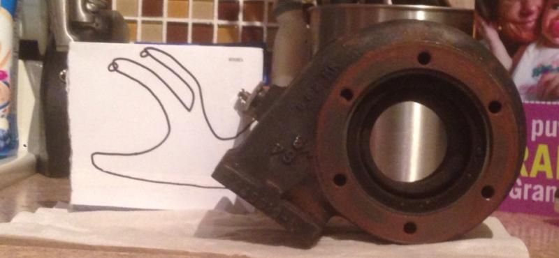

Got this baby in the mail today. Finally some faster spool.
.64 snail housing
Z32 with lq4 swap
Desert Street Scene || Dssevents.com
