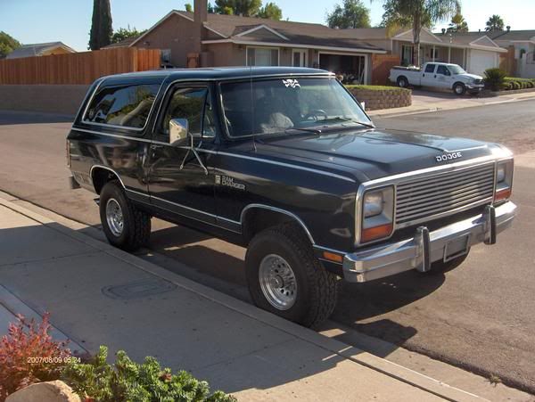

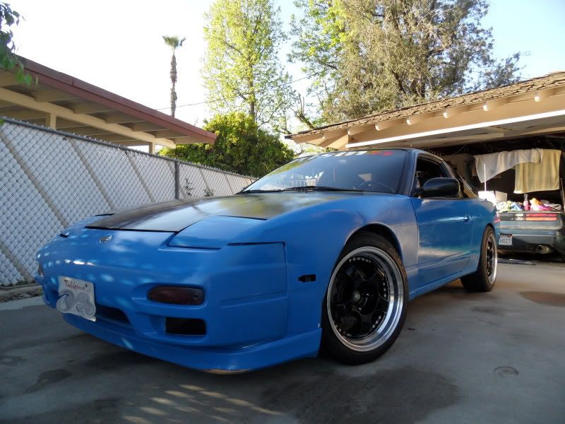

this paint job was done by rattle can. came out pretty clean if you ask me.

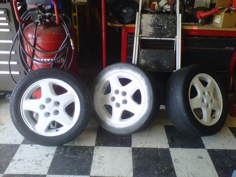

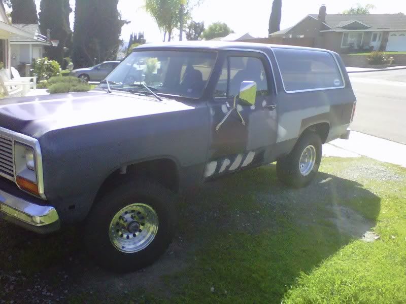

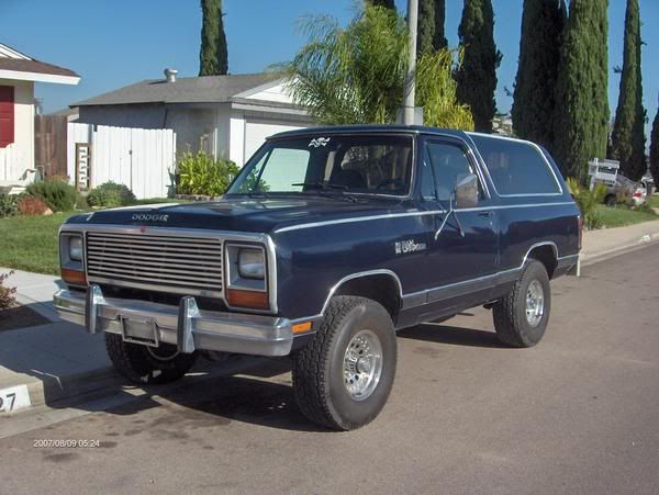

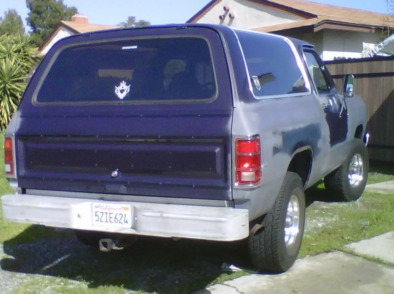

here we go.... 3 coats of each layer
primered flat black
painted semi gloss white
clear coated
didn't tape off the one tire because it has a massive hole in the side wall, so it was getting tossed anyways.
aaaand my old truck. it looked great and all when i bought it, but some douche bags keyed my truck (long story short, they targeted my truck specifically, came to my house, keyed it, and left. caught it all on camera). they wrote "fuck ecb" on it. ecb is a local gayng, so it was either a cover up, or they thought i was in the gang. idk. in the end, we decided to just do the whole truck, because it couldn't be paint matched due to the age of the truck.
heres pics when i first bought it after washing it, getting it running, and waxing the shit out of it.
so heres some pics of when we first started working on it.
a LOT of bondo when into fixing this, because it had a few dents, and some major rustage in the rock guard on one side, and bad bondo job on the driver side door previous to us buying it. drove it like this for awhile, because we lost time to work on it.
then we got back into it and finally finished it (minus the roof, sold it before then, so i could buy my 240.)
we also took off all of the gay trim it had on it.
this hood pic was before the hood was finished lol
and this is while it was wet... looked nice lol

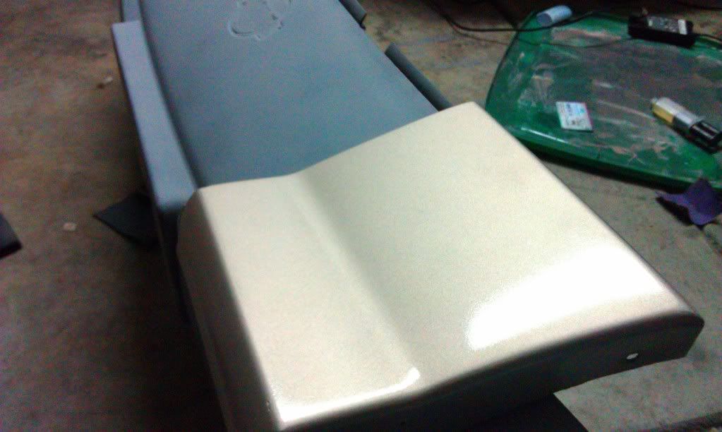

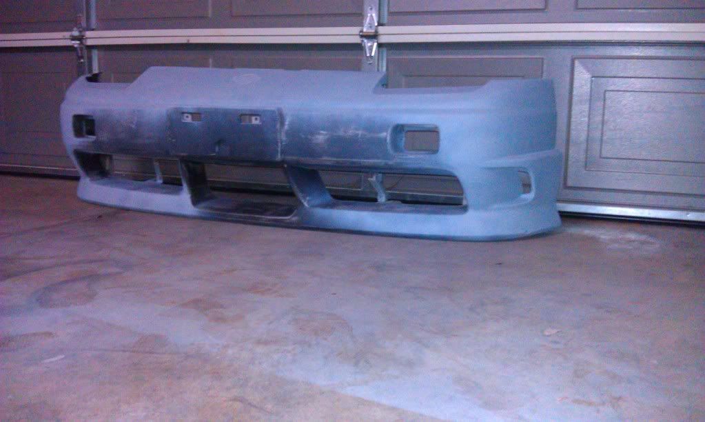

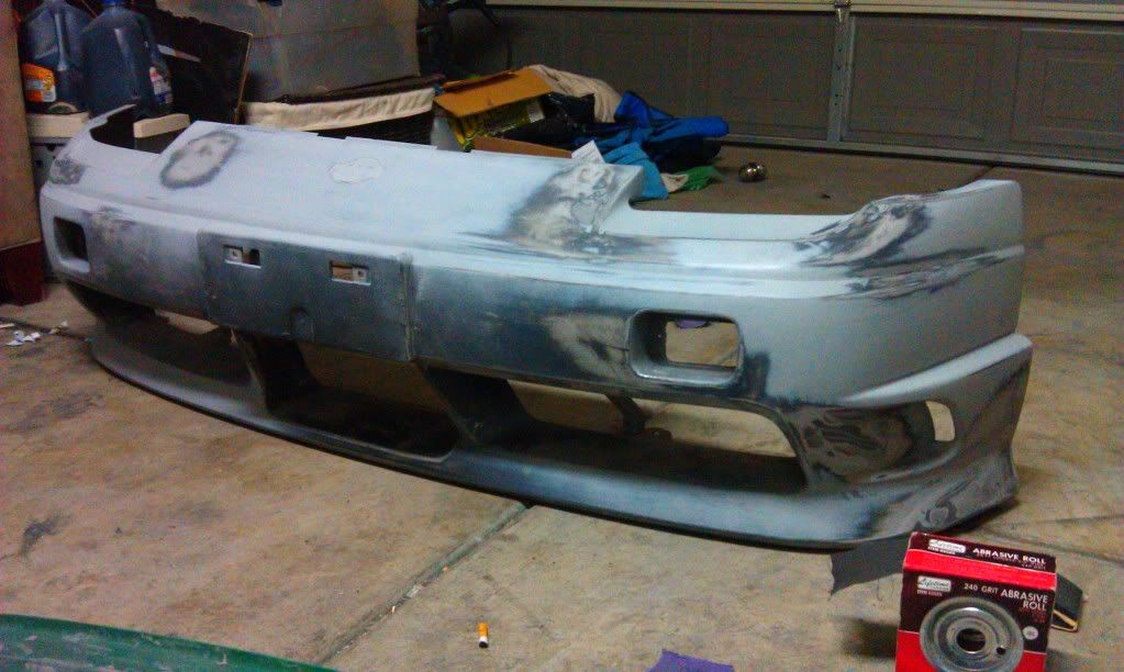

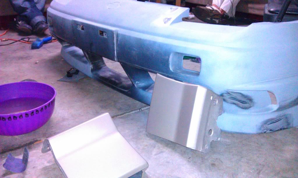

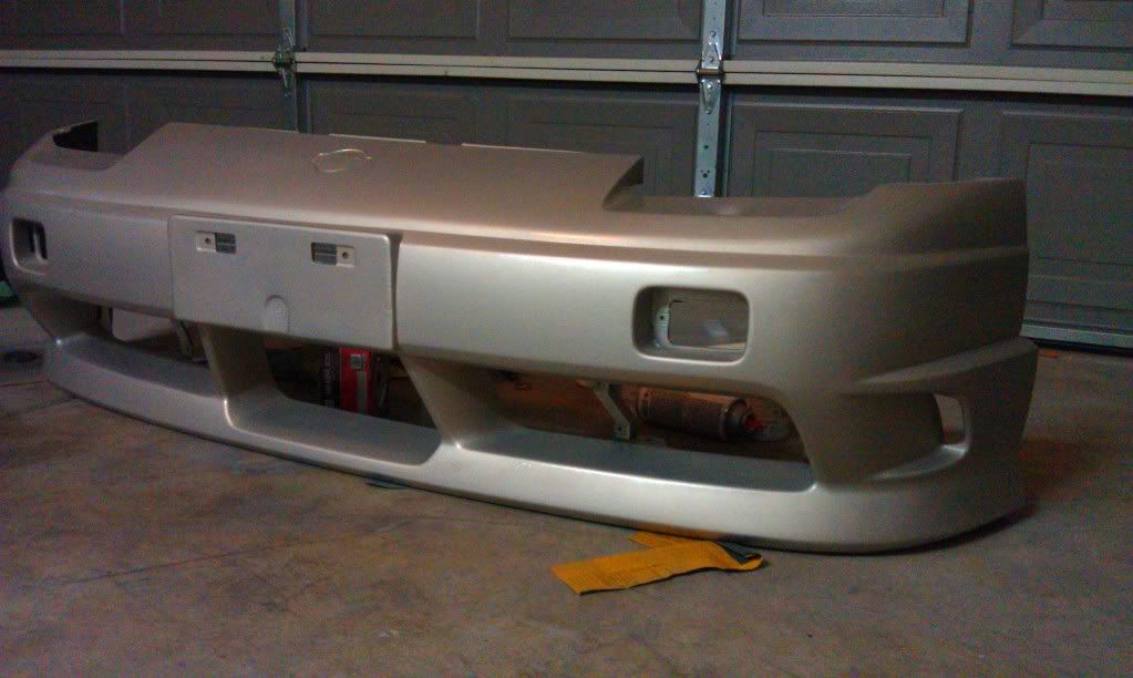

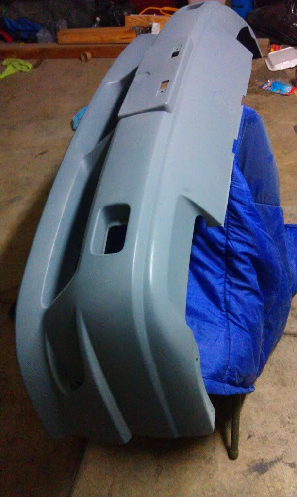

heres what ive been working on for the past few days
i picked up this:

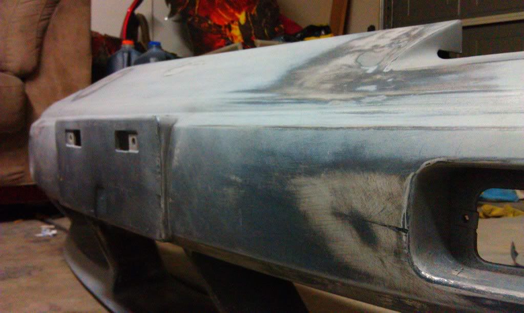

then i got to sanding, there is thin flat black spray paint over the OEM silver color with randm deap swirl marks from where it loks like he tryed to kind of half ass sand it..
real shame to, the silver i found when i chipped off the spray was beautiful, clear coat was still pretty.. had alot so sand and smooth out it was in pretty bad shape
there were quite a few gashes and big problems, but i wanted to get the first coat of primer to be able to see what it would and wouldn't cover

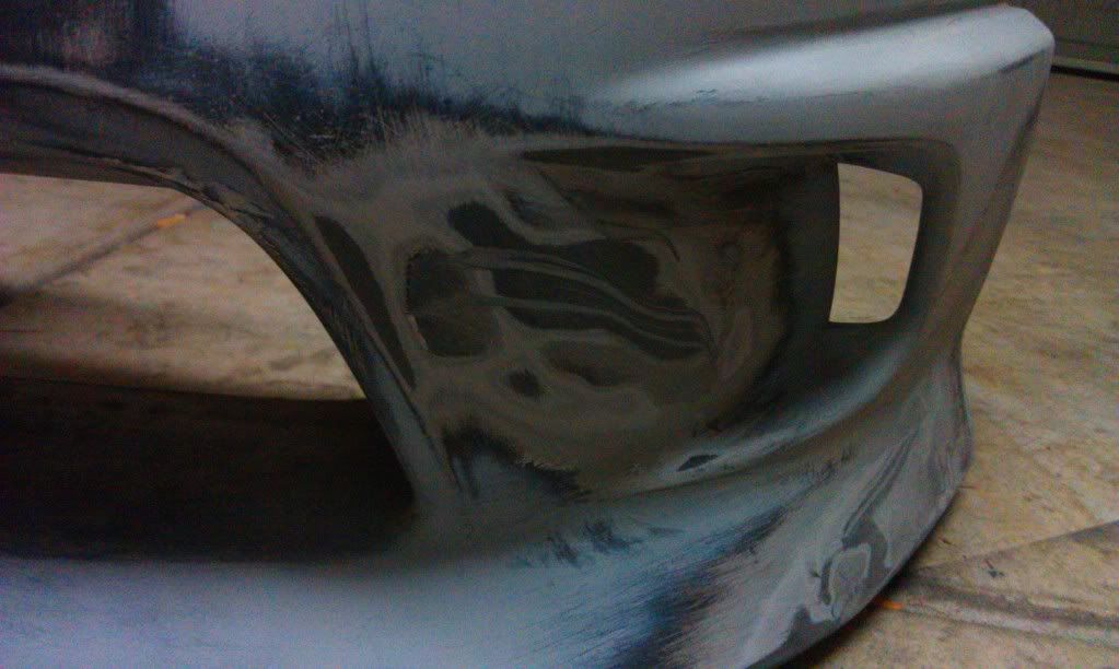

got to sanding the first coat and started to see what i needed to fix, i ran short on primer, but i got most of the placed i wanted to see for now..
got to sanding the first coat down and working with the larger gashes, i decided to do the side pieces real quick for some instant gratification:
This is about when i used epoxy and filled the big gashes after hitting them with some 80 grit
after fighting it all smooh and then after a 1000 grit wet sanding it was time for first coat of real krylon primer..
after a few more of those, about 3 coats and 1000 grit wet sanding cycles of krylon nickel satin and about 3 coats of krylon clear and 1200 grit wet sanding cycles here i am.. i still need to do another good coat of clear, break it down to a smooth layer and buff it..
my car is oem champagne
this is right after the most recent spray of clear, the clear isint very shiny at all, and it layed down pretty bumpy.. lets hope it clears up with a few mroe coats, wet sanding and buffing :/
cheesy pic of car for color: (girlfriend car..lol)
any tips guys or thoughts, im not really trying to get the surface ? this is still % right now and i know it wont really match, ill do that when i repaint the car, so i didn't fill all the smaller things, meh. work in progress..
