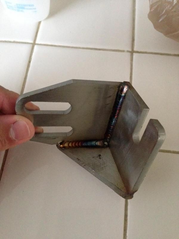

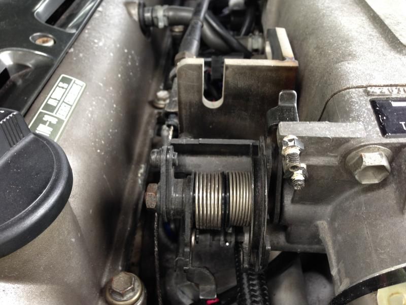

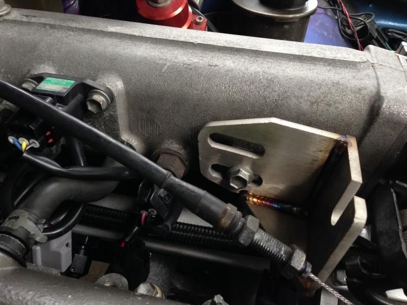

2JZGTE Swapped S-Chassis thread
Finally got a couple pics of the CX cable bracket

Yo my bracket didn't line up worth shit on my non vvti 2jz! I have one of these for sale if anyone wants it for their 2JZ VVTI
$40 Shipped
