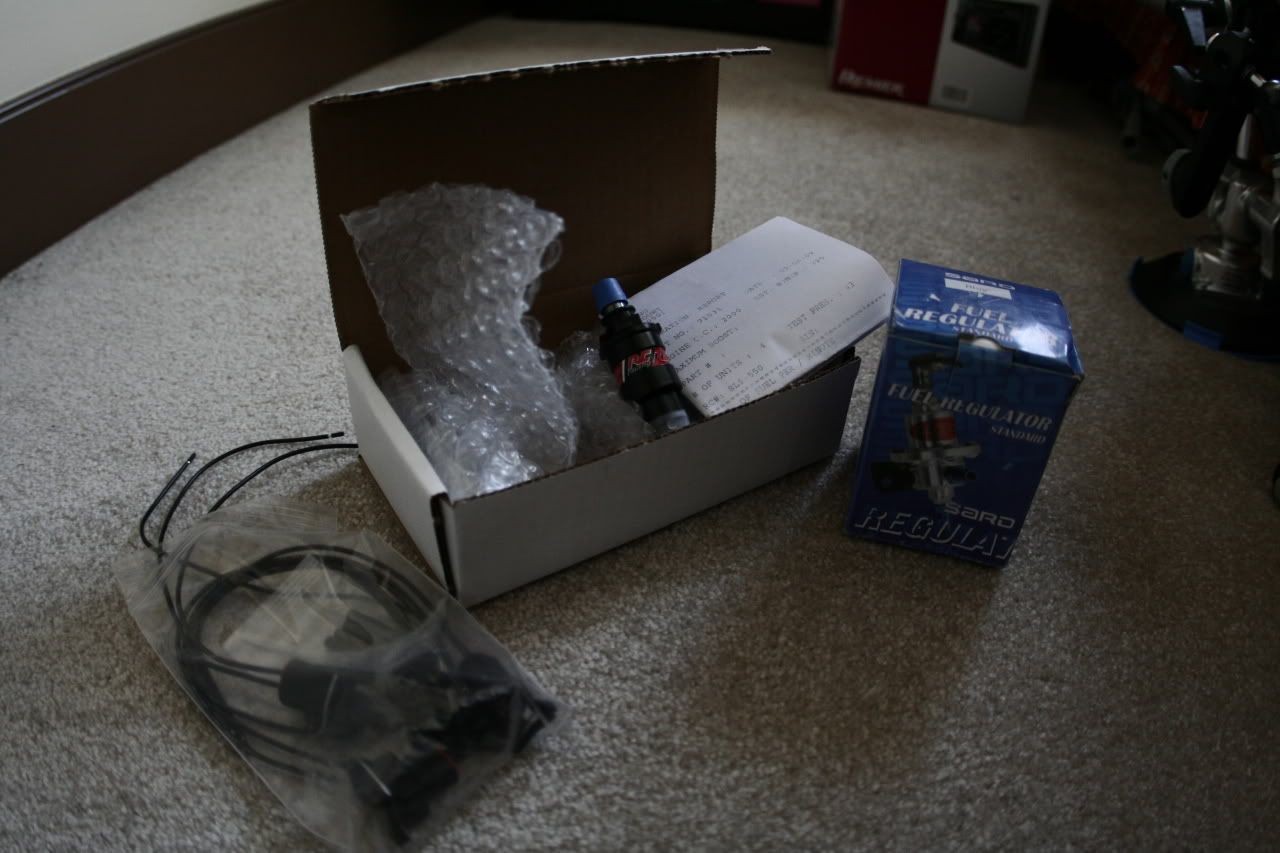

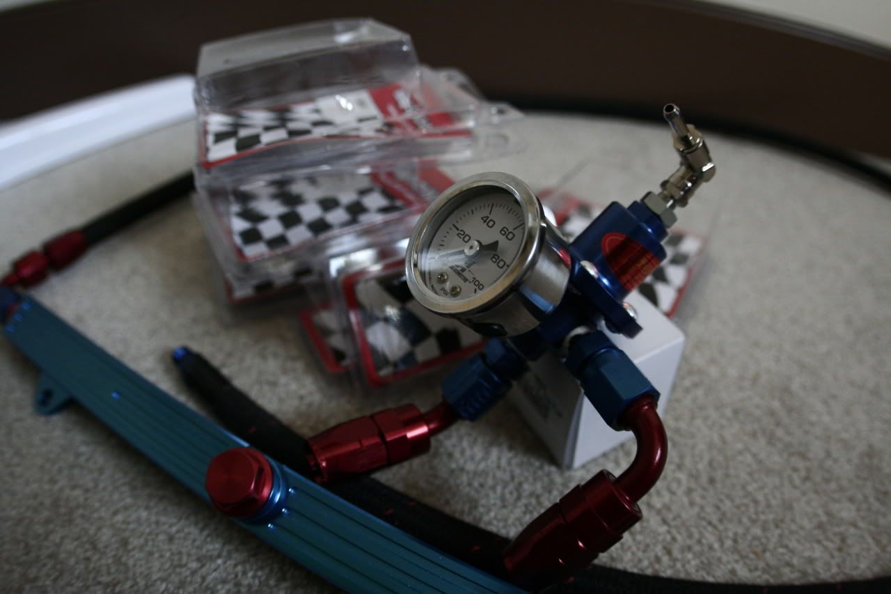

Ordered new fuel rail, regulator, top feed injectors and an fittings for new manifold set up.
So no pics of any of this yet.

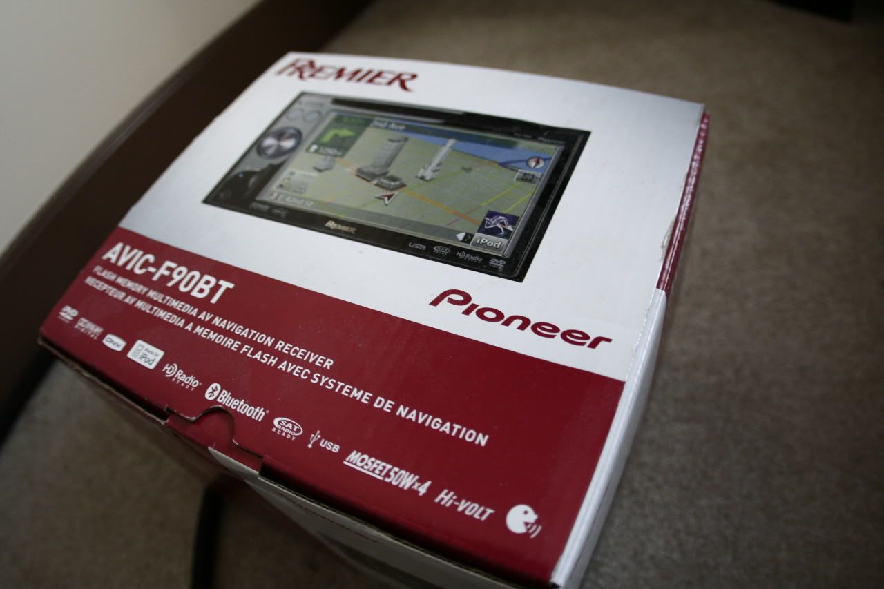

Can I ask which specific double din kit you are planning to use?
Old 04-07-2009, 03:09 PM   #433
Taniguchi_Is_#1
Join Date: Jun 2004
Posts: 3,141
^^ read the box? avic-f90bt. ballin'
Premier Pioneer F90BT - If your talking install kit or something? i just fits with stock mounts.
Its a pretty dope deck, looking forward to pwn it. Lots of software mods available for it.
kuruptR, your car makes me want to get back in an s-chassis.
I meant the install dash kit sorry...
Yeah, the install kit. I did not know that it would fit. Thanks for letting me know. you wouldn't happen to know if that's the same for the S14?

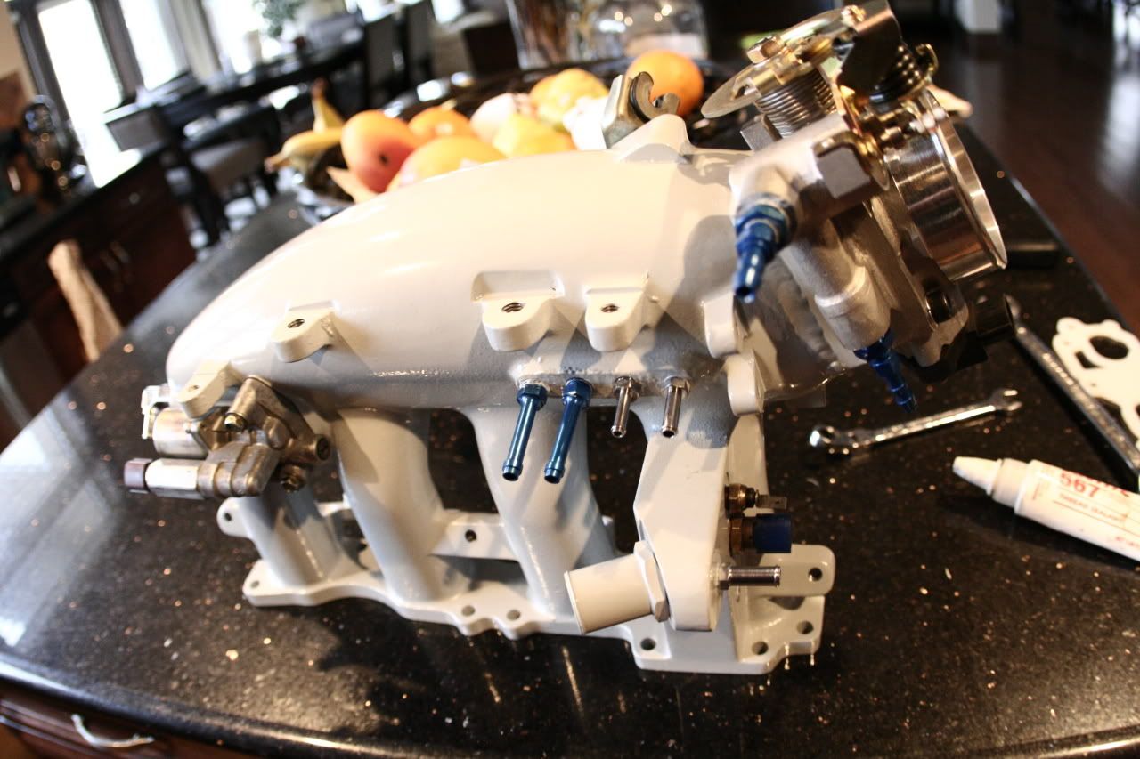

Manifold Complete, chopped off old throttle body flange. Then Polished it smooth, and powder coated it glossy grey. Powder Coated the ugly blue Greddy Fuel Rail, the powder nicely filled up the cnc'd Greddy logo. RC's placed and FR mounted, i like the color combos, least blue possible.
Having trouble threading a few things, the coating is thick... gotta go to work tom and re-thread a bunch of things.

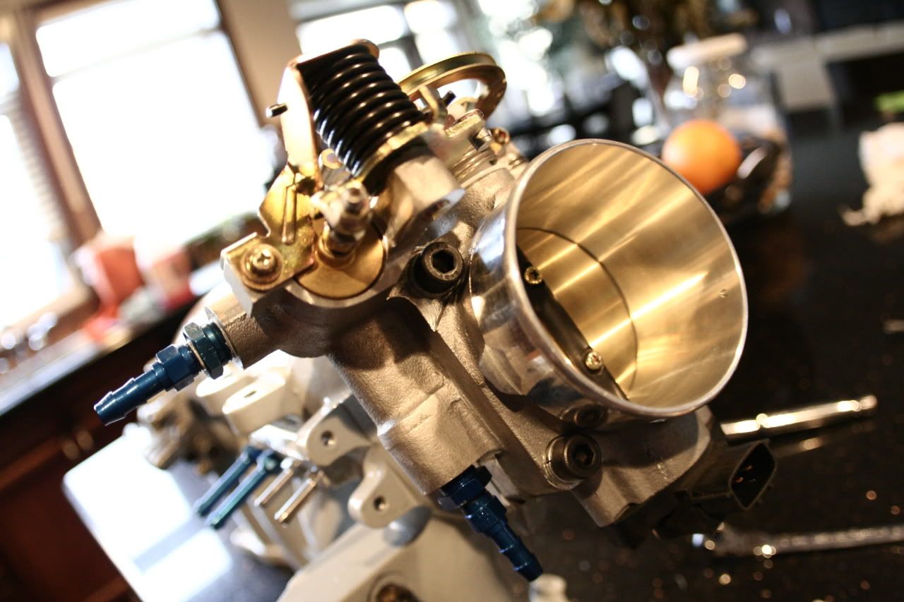

N15 Throttle Body, Adapter plate welded onto the manifold.

installing the manifold, having problems with the throttle cable and the new TB.
I need to lengthen the cable or clock the throttle pulley.... anyone know if clocking it is a good idea?
the pulley is virtually the same as the s14, its just clocked a lot more.

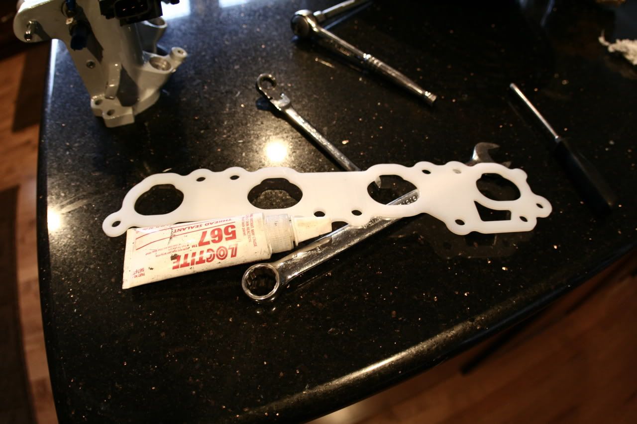

Had to modify the the N15 Throttle body: removed sleeves, then tap'd it for 1/8 npt. Swapped the S14 pulley in for the N15's
manifold together, ready to go in.
Hondata style Heatsheild gasket from phase2motortrend.
