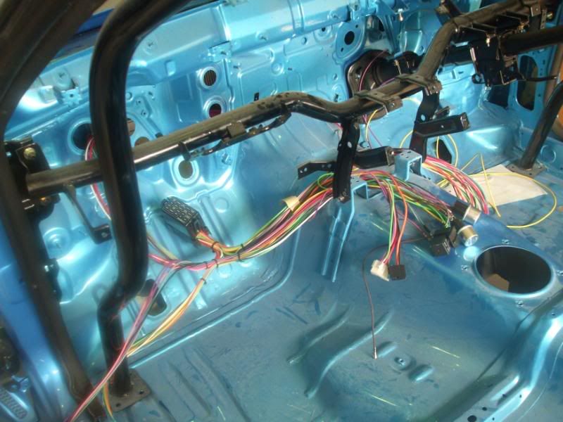

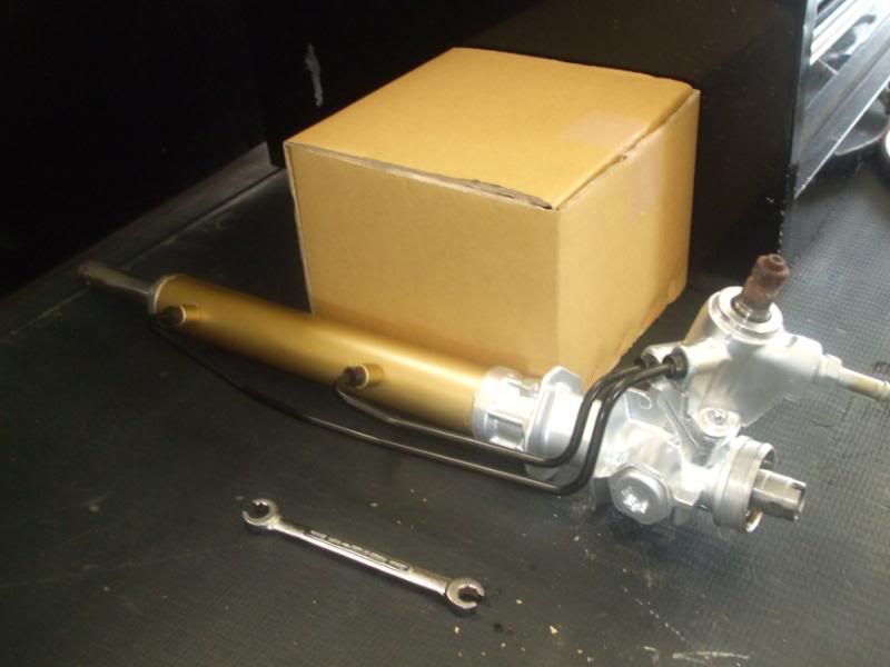

I did the little paint job on the power steering rack, not because of any lame requirement other than my OCD and everything needing to have a dash of flare added to it.

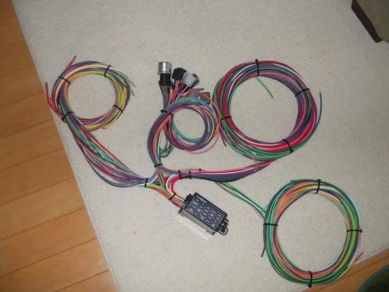

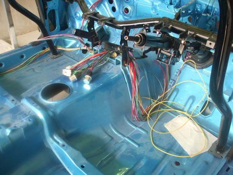

I also got the wiring harness and started routing it through the car and determining what I am going to need as far as relays and shit. This particular part is going to be a huge pain in the ass as far as I can tell.
Once this is done, we will start on fuel and hydraulic lines and other requirements to make this a rolling chassis by August.

keeping the cage black? im surprised it isnt sprayed in some one off color that you've taken 8 batches to get JUST right.
Is anyone helping you out with the wiring, or are you just basing it off general knowledge you have?
nice work, as always.
I thought that the Black Cage with some of the other stock reinforcements would look good kept black and kind contrast with the blue in a way that complimented it. BUT I did consider painting the cage in Mirror Chrome, however, it was a little overboard.
I have some people helping me out with fundamentals on the wiring, but for the most part, I am just taking my sweet ass time and learning it as I go. I kind have to build a dashboard soon as well.

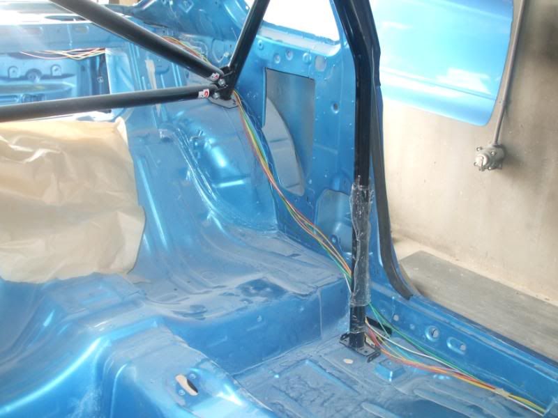

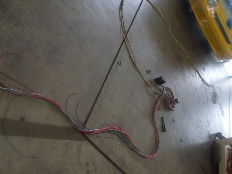

Wiring
Now this wiring thing is a pain int he fucking ass. However, I think I amstarting to figure it out. I would love to be able to beat this thing with a hammer and make the wires work but that is not going to happen.
I am using an EZ Wiring Harness and between their manual (which sucks butt) a painless manual (which is much more thorough) and an FSM I have come up with the following diagram that should depict how to get power to the harness. Now I have not included switches and all that jazz but I will as this little project evolves. I will even include pictures but for now this is what I have for the start up and charging system. Some of my arrows may be pointed the wrong way but I am pretty sure I got it right.
If you know what you are doing with wiring like this please feel free to comment or lend advice. I Would love to turn this little section of my build into a how to, for guys that want to do this kind of stuff int he future. I always see it done or alot of questions asked, but have never seen a thorough how too.
Red = Power (However each type of marked power has its own wire as depicted in the picture).
Black = Ground
Purple = IGN Switch Start
Dark Grey = Alternator Excitor
PowerWires Explained:
Battery Pos - Starter Pos Post
Alt Pos - Alternator Boot
8 Gauge Power - 100 Amp Maxi Fuse (Used in place of Fusible Link)
Alternator Boot - Maxi Fuse
Maxi Fuse - Solenoid Power on Harness (This is where the Harness gets power from)
Alternator Excitor From Fuse Panel - Alternator
An Additional wire is added from boot-alternator terminal
Alternator is Grounded to Engine Block
Ground is Ground
Starter Relay
Ground
Power Constant from fused Wire to Battery
Purple Ignition Switch from fuse box to Relay From Relay to Starter Signal.
Maxi Fuse replaces Fusible Links at 100 Amps Rating
