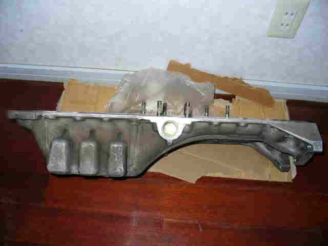

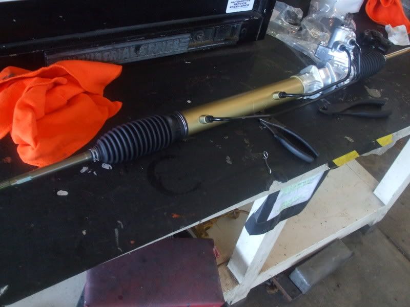

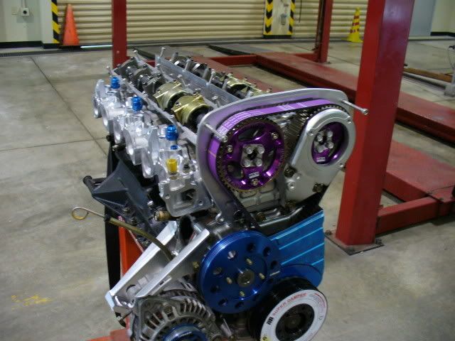

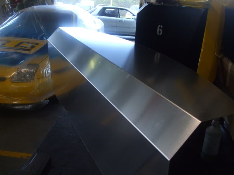

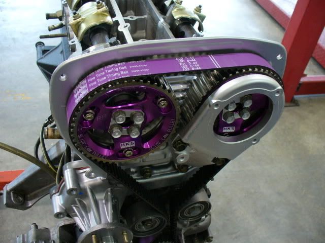

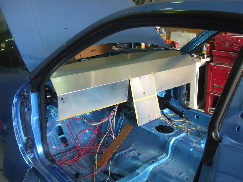

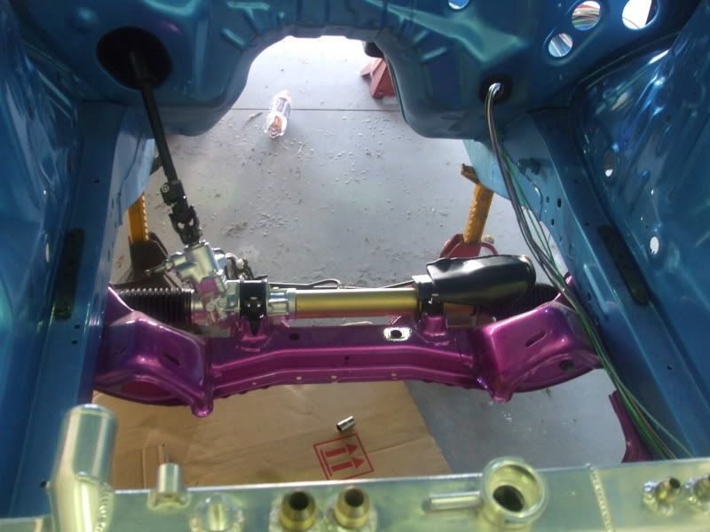

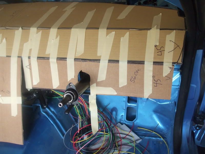

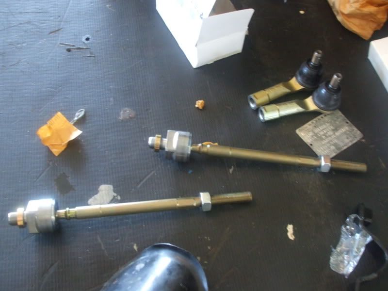

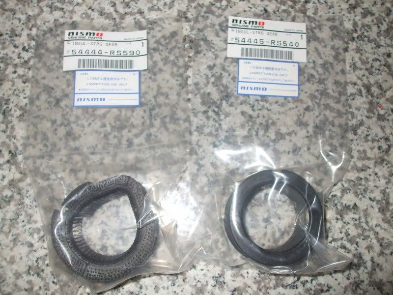

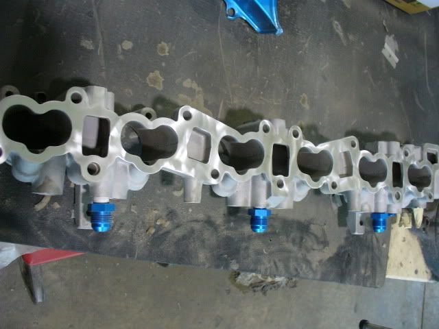

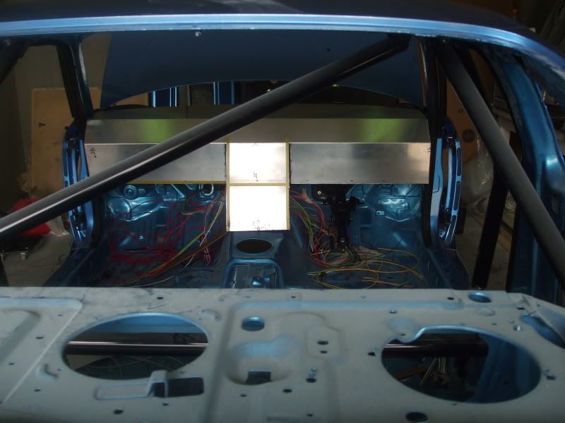

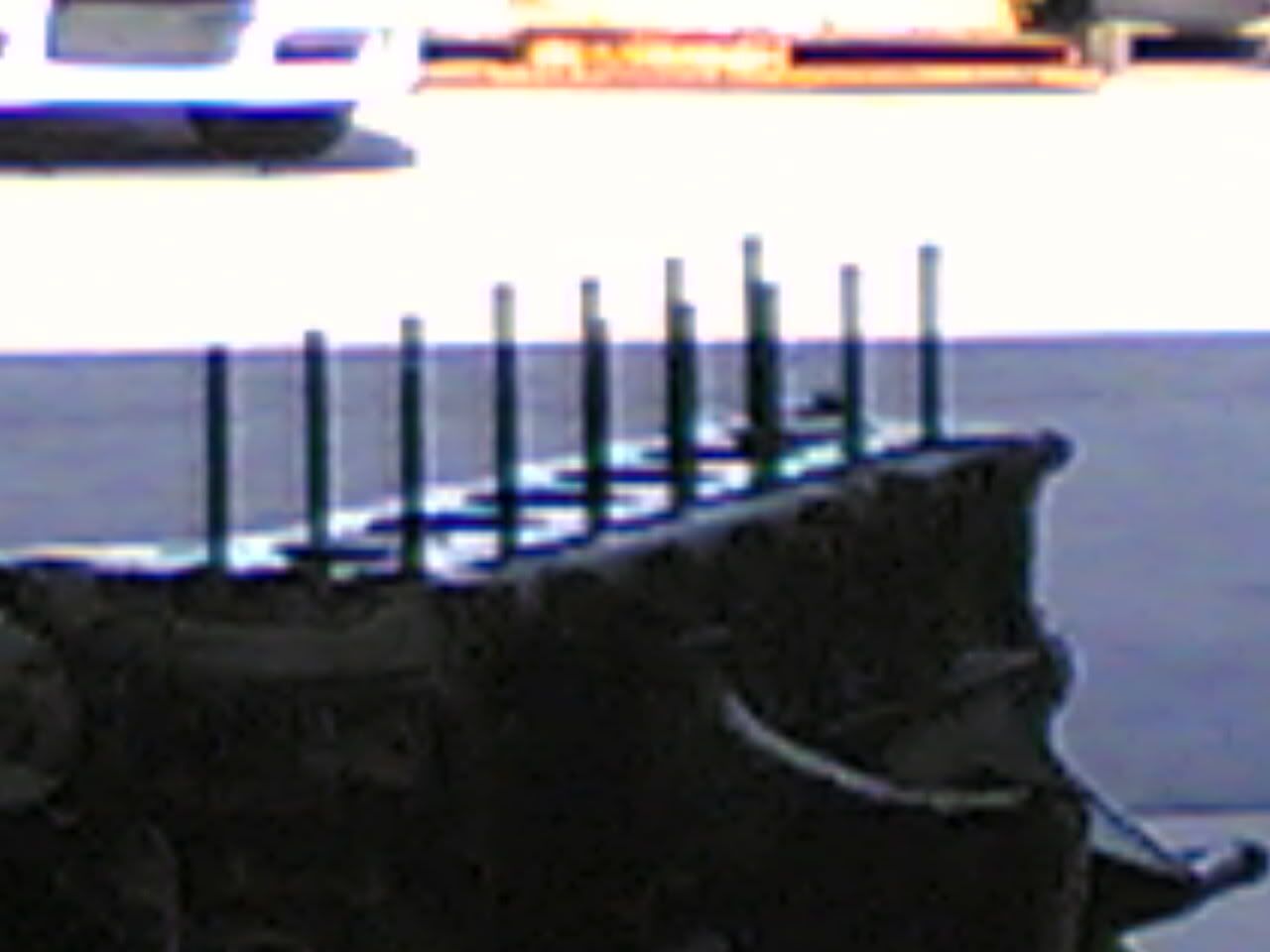

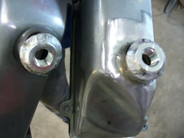

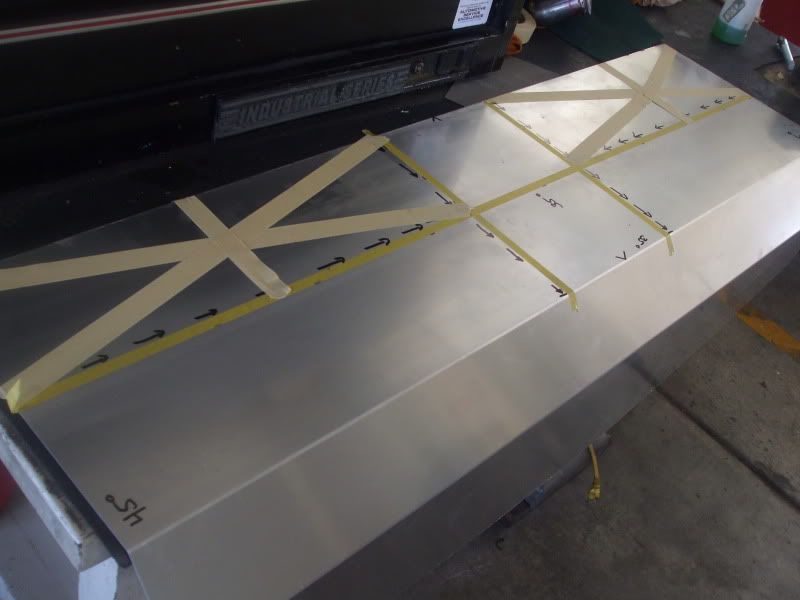

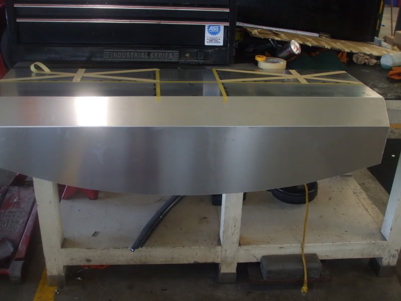

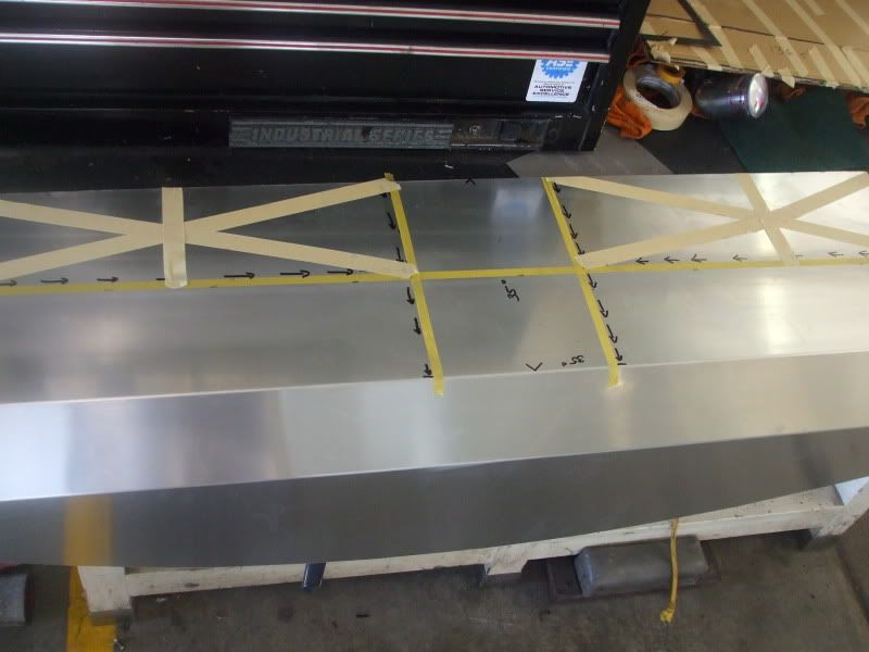

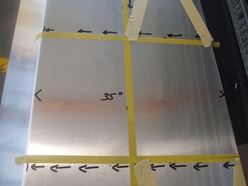

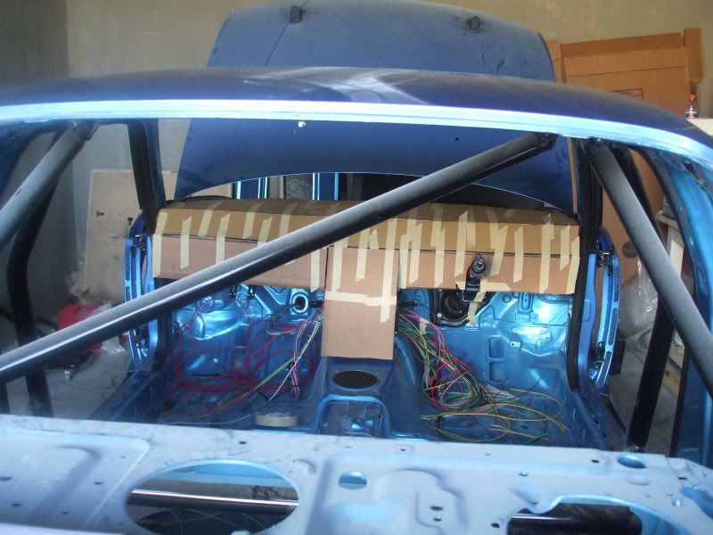

Here is another update:
Got the power steering rack put back in. I originally planned to powder coat the POS but I didn't feel like fully disassembling the rack since the rebuild parts were about 180.00 from Nissan and there was no reason to rebuild a perfectly good rack just to make it colored. I used some Nismo Power steering rack bushings, they are pretty rigid and appear to be a hell of alot greater quality than stock but we shall see. I wanted to go with Yanak Aluminum ones but they were just a bit overkill and I doubt the cost was worth the pay off at the end. I also threw some Tein Tie Rods and Tie Rod ends on there with nice new boots.
I am still working on acquiring everything for the wiring harness to get completed but kind of took a sidebar to make a dash so everything would sit where I wanted it to.
I had originally planned to use carbon fiber and pop off a copy of the stock dash, but two things turned me away from this plan. Primary reason was the fact that creating a suitable mold was going to take a very long time since I wanted the outer AC vents eliminated, second consideration was time. I hade 2 4X8 sheets of aluminum laying around and decided to mock up a cardboard dash and then have the basic shape cut and bent from one of the sheets and then use that bulk shape to perfect and create a good aluminum dash. All you HATERS that are going to talk shit about glare like I don't know what the hell I am doing, once the dash is complete it is headed to a guy here to get a nice coat of wrinkle black powder coat.
Anyways, pics below as usual.

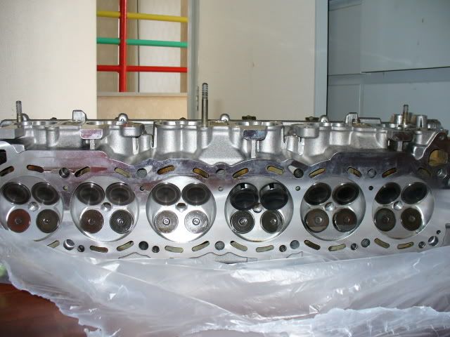

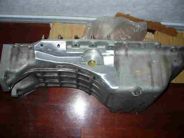

Some of the Engine Progress Pics as promised as well
Sorry I don't have more but alot of things I did I did not take pictures of and soem thigns were done by a shop in town to ensure that clearances and other things were correct.

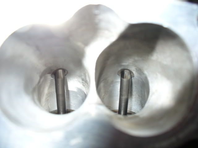

Originally Posted by CursedGTR View Post
Was this head cnc ported?Because if so It looks like all my motors I get done just for myself.LOL
luisgonz is offline
Old 07-26-2008, 04:30 AM   #14
CursedGTR
Join Date: Aug 2007
Location: Birmingham, AL
Posts: 423
CursedGTR is close to perfectionCursedGTR is close to perfectionCursedGTR is close to perfectionCursedGTR is close to perfectionCursedGTR is close to perfectionCursedGTR is close to perfectionCursedGTR is close to perfectionCursedGTR is close to perfectionCursedGTR is close to perfectionCursedGTR is close to perfectionCursedGTR is close to perfection
No, it was a regular old port job but it was smoothed over with some 80 grit cylinders. Not too much over stock at all. The cylinder head itself was CNC however.
Cool. Run the number by me if you can(Price, Dont worry I wont open my mouth). Love that port.

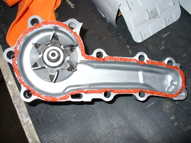

You put on silicone like you're welding aluminum
Never really noticed that.
But those are soem cool silicone beads though huh??

Good stuff with the sheet metal work. I've always been a fan of those that can pull it off nicely.
Doesn't anyone make Permetex Gray, or Hondabond in Japan land...that orange sillicone gank is so redneck on such a pretty build!
That orange crap is the Nissan Pit Work Silicone, Although orange it is extremely thick and has a consistency a little above RTV. .
I assumed that's what It was, I just can't stand the way it looks on fresh motors hehe. Not sayingn it's junk, just asthetically speaking hehe.
