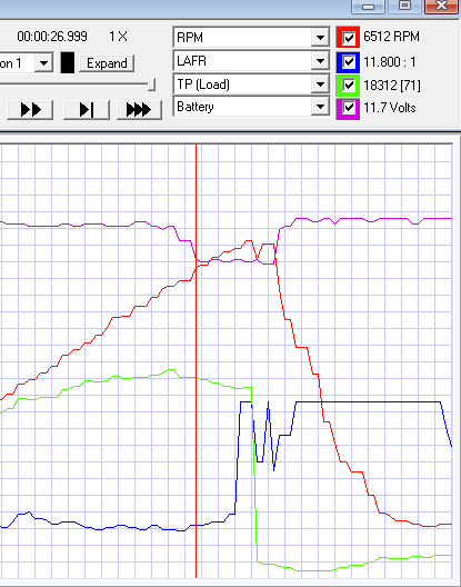

Im running regular coppers one heat range colder. In either case I'm gonna go with iridiums bkr6eix should work fine in the application.
I dug a little deeper and realized what the problem, For some reason when i would give it just 1 degree of timing more at 6000+rpm , the battery voltage would drop drastically to 11.5 volts, the super charger belt and the alternator belt are on the same pulley.
Its really strange, i have two logs with the same occurrence when i add the timing, i think the belt is slipping on the crankshaft. The belt is pretty old so I'm gonna change the belt and the plugs and do some logs and see if it gets better.

Then I'm at a loss, maybe the alternator is going out? Its charging 13.2 volts at idle, that seems a little low.

is boost dropping also? do you have a map sensor to log?
Yeah, it should be a little closer to 14.0 volts.

well in typical fashion with me, after hours of work it was something simple.
3.5 hrs of changing alternators, redoing belts , tensioners, and what not. Still 12.8-13.0 volts at idle. Long story short, main fuse box power wire was loose, tightened the stud, voltage at 14.1 volts.
ARGGGG.
of course said wire was buried behind the dashboard and a nightmare to get to.
