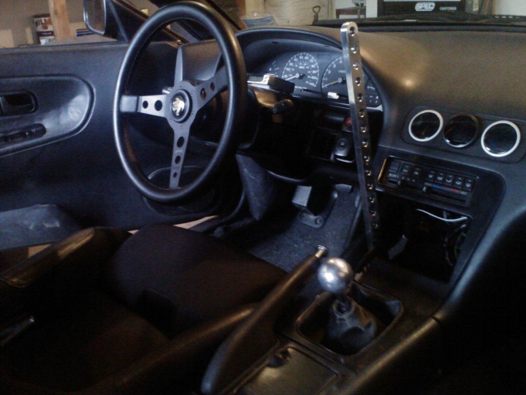

I'm using 3/4" Wilwood cyl
Stock s13 calipers, Shitty autozone pads
Handle is about 16" +/-
Locks super easy, good amount of travel on teh handle as well. Locks at 5mph to ---mph, straight line, no problem.
I think it has alot to do with the way the leverage point is.
There is a very nice setup. Where can I buy a handle like that?

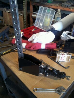

looks custom. you can get a similar one assembled and ready to go from ASD motorsports for 180. its pretty amazing. this is the standalone master version
