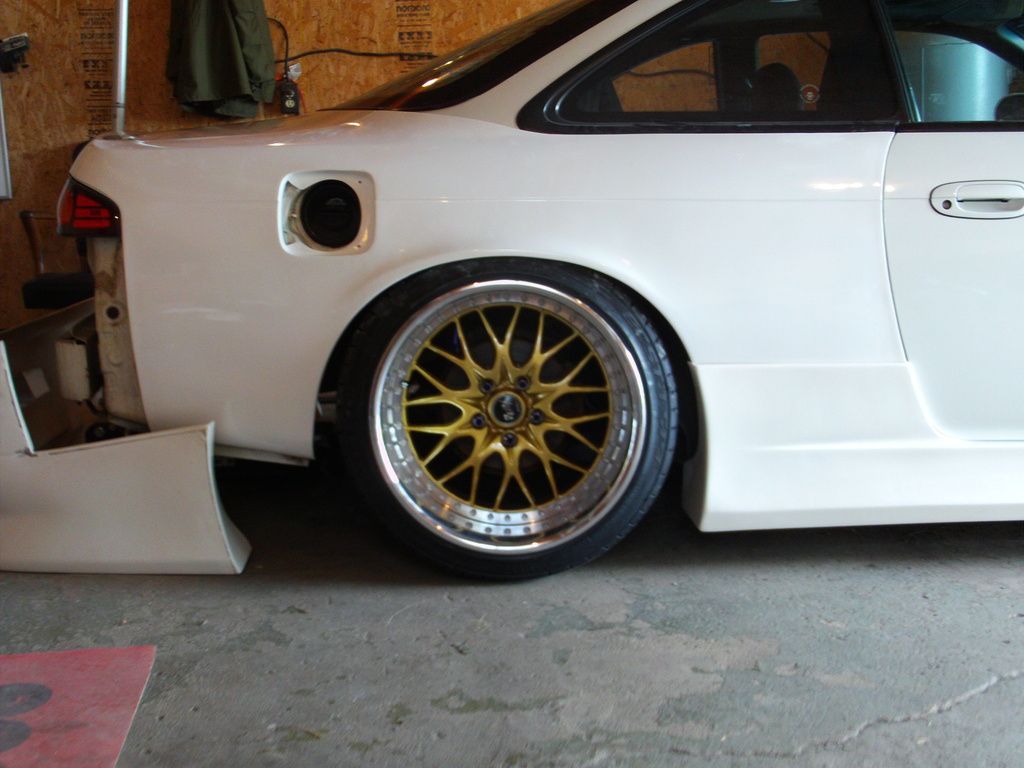

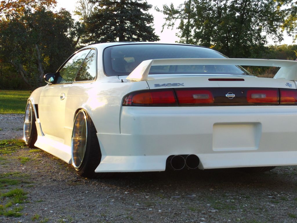

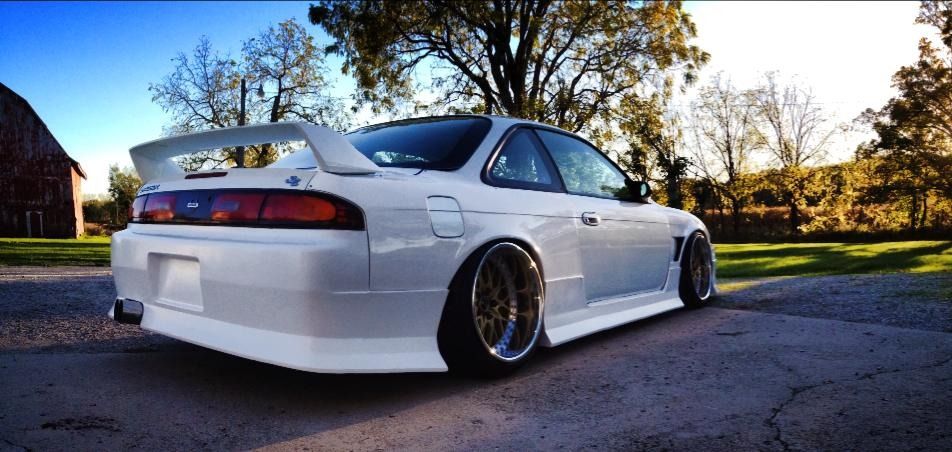

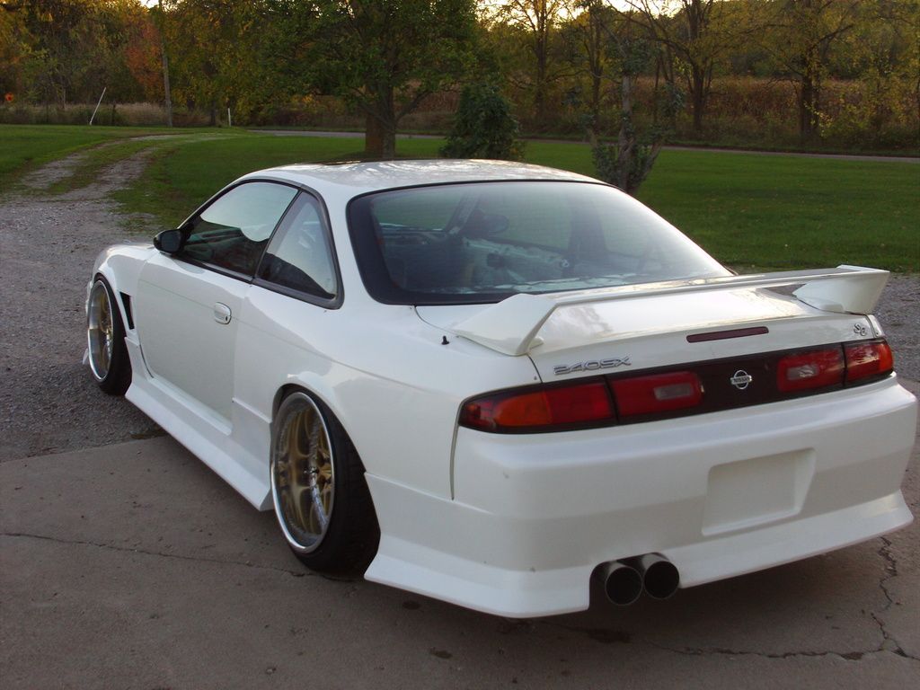

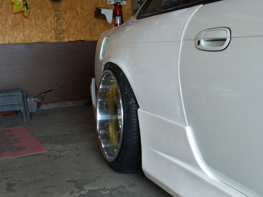

Originally Posted by Kuma View Post
anyone have detailed pics of charge speed rears on s14? I was planning on going origin, but now I'm unsure... eastcoaststeeze pulled them off nicely, but if charge speed has better out of box fitment I'm sold.

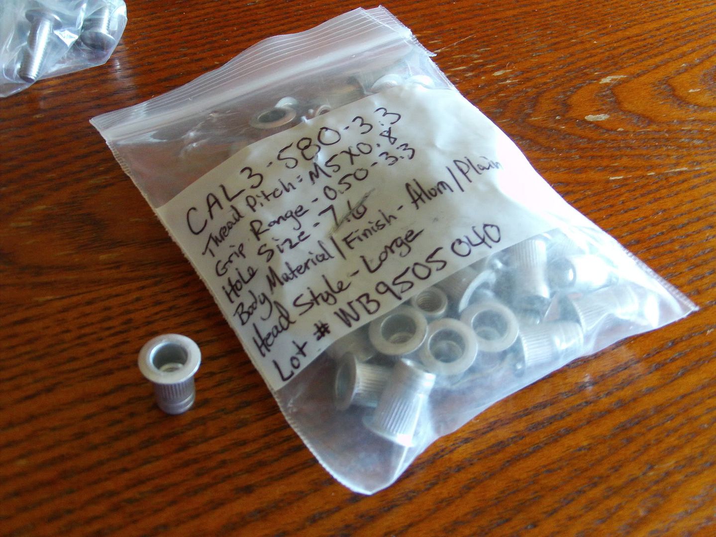

Here are a couple of mine at mock up stage, I think the skirt was the only thing holding them on.
Used these, rivnuts, to mount them for easy removal (9 per side)
Mounted

Looks dope. Rivnuts are the way to go. What size did you use? I need to get some
M5? The part number is from Fastenal and I used SS button head bolts. I totally took the idea/part #, whole shebang, from a Modified Mag. article they did about putting overs on a time attack S2000. (March '10 was the issue)

Thanks 1day! Your car looks great.
Those look great, those are the 50mm charge speed ones, right? I'll add those to the OP later. May I ask why you decided to go with rivnuts over just rivets?

Thanks guys. Correct 50mm chargespeed's, I went with Rivnut mainly for cleaning. I get a lot of small stones behind them.
I'm so bummed about the quality of the origin type 3's. I was thinking about selling mine for those but IDK now.

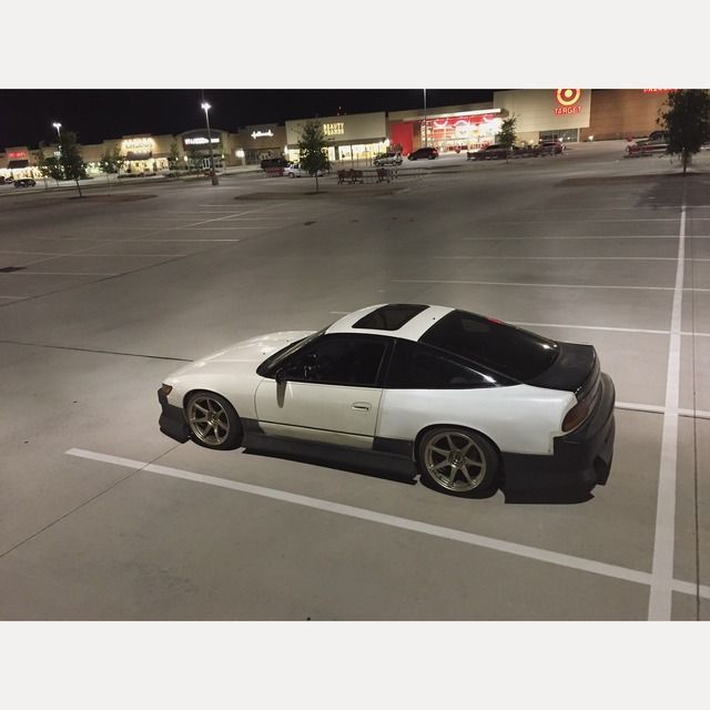

FineLine Tuning 50MM
S13 Hatch
$299 before shipping. Think $350 shipped
Tatakidashi reps pretty much, or very similar.
Actually fit pretty damn well. A little bit of trimming but that's it really. I'd say 7/10 at minimum.
Don't really have any other close ups but I can get some if someone wants to see them.

I Did riv nuts for my overfenders we use all the time for other builds. they help with everything

What size wheel, and spacers? Because I have a 18x11 (you have 18x9.5) I have 25mm spacer (idk about you) and it looks to be that my wheel still wont fit flush and will be tucked a little
