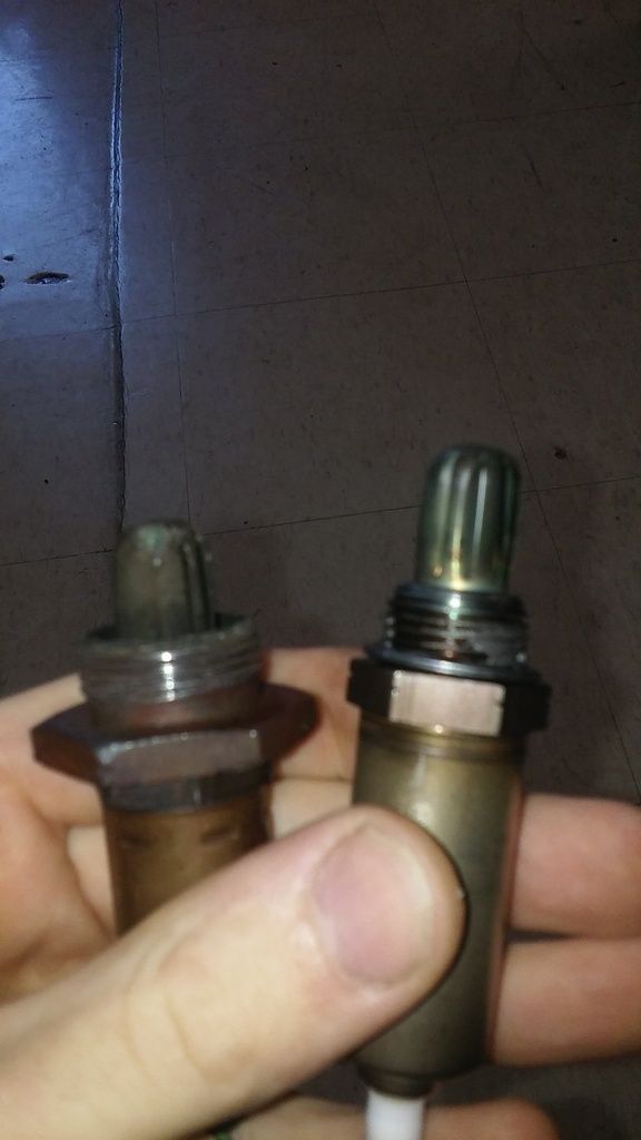

Tried that because apparently the threads from 11027 are m18.x15 but they are NOT. This didnt work and now i have to send it back and find the right one.
It's just a friggin 02 sensor im about to lose my mind

https://photos.app.goo.gl/xpnZ6FrJonbzfe7t2
Mine is the one to the left, the thread are bigger than M18X1.5. I just need to put my new 02 onto my header but want to avoid welding it in. I know there has to be an adapter...... i just CANT find it

That 02 sensor has the adapter still on it. Maybe I'm missing something carry on.
Sent from my LG-H631 using Tapatalk
I cannot find that adapter anywhere though. Anything related to s13s, 240sx, or ka24de or ka24e shows different adapters. i even ordered one off FRS Sport and it doesnt work.
And its STUCK. that shit isnt coming off lol

He's saying that your o2 sensor (on the left) still has the adapter still attached to it. You need to unscrew it from the o2 sensor. If it's stuck on there, spray some PB blaster or whatever penetrating fluid of your choice, onto the threads and then try unscrewing the adapter from the o2 sensor.

LMAO...yea the o2 litteraly has the adapter ON IT
haha
Hope u figure it out
