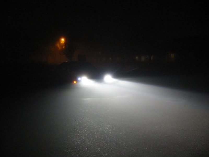

This is 4300K it's only yellow/white on the ground.

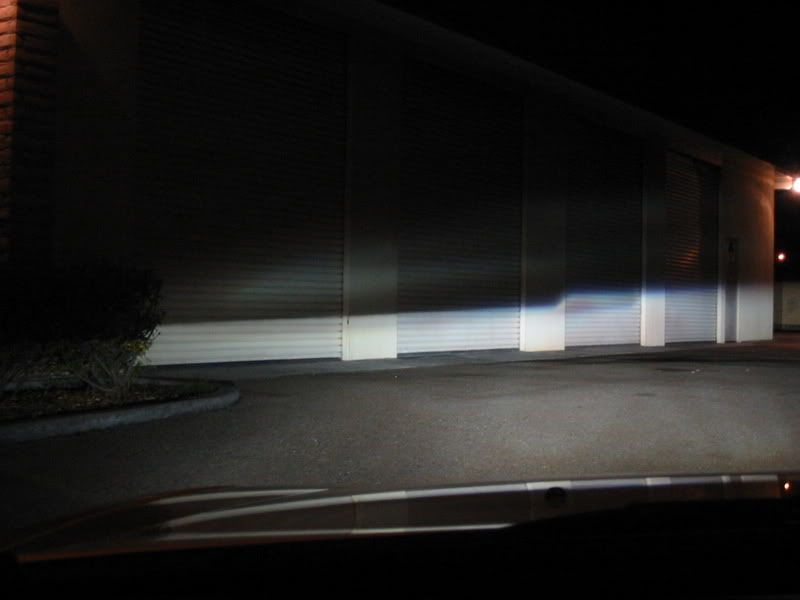

My 4100K:

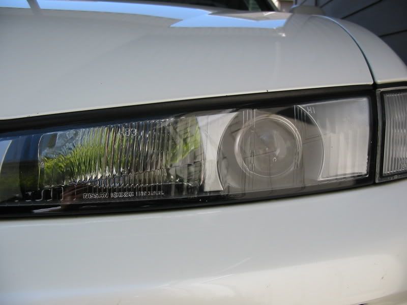

^ see how the S15 headlights have such a clean HID output? it's because the lens is totally clear, unlike S14 Kouki headlights (USDM) with three vertical lines and tiny angular defractive "steps" in the glass design. See below and see what stands between the projector (s2000) and the outside of the headlight. Those 4 lines on either side, plus little steps in the glass. Through a lot of observation, these are used for overhead lighting.
Also, the glass has a design which travels horizontally across (about 15 degrees from the horizontal) from it, and continues to the clearance lamp (next to the headlight) and continues on to the fender, door, etc. That actually bends the light on some projector designs...again, it upsets the sharpness of the cutoff.
anyway..the first is a good pic when i installed oem hid projectors last year. It doesn't look nearly as sharp now, so I'm going to have to open up my headlights again for the um-teenth time this weekend and play with them again. The 2nd pic was taken not too long ago. BTW, 4100k cuts through fog very nicely contrary to what people have said. Going to GT Live with fog for almost 80% of the drive made my HID conversion very worth my while (for the amount of work put in, difficulties..etc).
