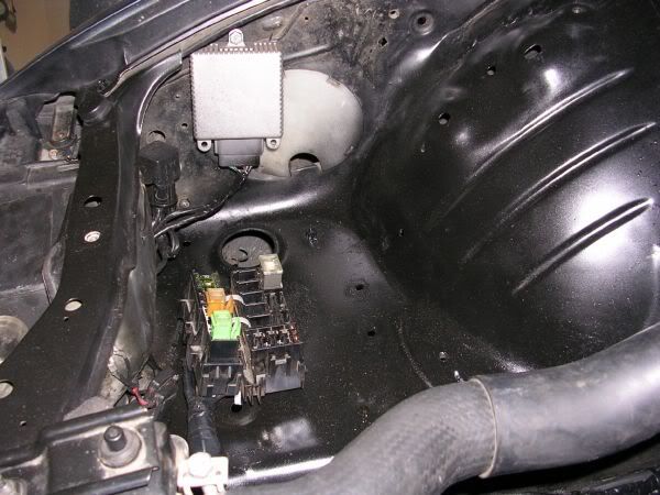

Ya missed my post about your fuse box n stuff..

Oh sorry. I tore apart the fuse box. I pulled all the fusible links and fuses that I didn't need and was left with like 10 wires, 2 fusible links, and 2 fuses. So I cut off all the extra plastic that the other fuses were stuck in. Then I cut out a bunch of the wires I didn't need, shortened a bunch of the ones I was still using, and wrapped it all back up. I ended up putting the few fuses that were left just behind the core support behind the passenger headlight. I'll post up pics this afternoon. I chose to put it there instead of lengthening the wires to put it back in the cab somewhere. The less the resistance, the better. Then I took the wires that ran from the battery to the starter and fuse box, and put them in a distribution block behind the passenger shock tower, and put the battery in the back of the car. Worked out pretty well.

Wow, that's awesome.. I'd love to do that. Except I probably need most of the stuff I have... Yah, pics'd be cool. And if you're feeling extra generous (or bored) a list of things you aren't using.

Here's a pic of my fuse block now.
What am I not using anymore?... hmmm. Well everything you don't need to run an engine or turn on your headlights. No A/C, radio, heater, etc... I'll eventually do a painless wiring harness, so I can scrap the stock harness alltogether.
